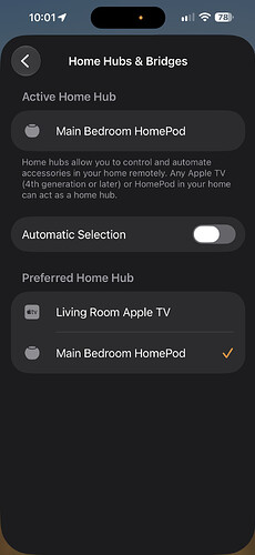

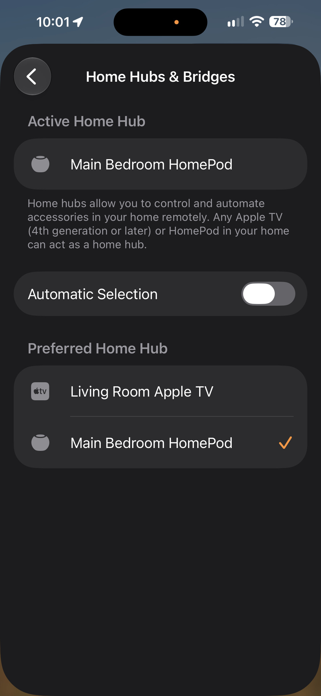

So, trying to get my apple tv hd and homepod mini to act as hubs so I can record from my aqara g3 camera to icloud. Nothing I've tried works. I've done the igmp snooping on and tried every version, no dice. Tried with it off, no dice. Disbled network acceleration. No dice. Turned off adguard handle client requests. No dice. Turned off bssid reandomization on 2.4/5g bands. No joy. Now I go where I shouldn't 'cause not really know what I'm doing. Used LuCi and made sure snooping and querier were on and rebooted and powered tv/homepod off for a minute then back on. No dice. Added @@||apple-dns.net^, @@||icloud.com^, @@||apple.com^, to adguard filters in case they were being blocked. No dice. Installed avahi mDNS reflector and enabled it. Still no dice. This is all I get in home hubs & bridges: no connected, no standby, just dead.

Thank you for the time and effort you have already put into testing this. We understand how frustrating it is to go through so many different settings without getting the expected result.
For this setup, could you please start with the following simple topology:
                Internet / iCloud+
                   Flint 3
                 Main Network
         HomePod     Aqara G3   iPhone
           mini                    │
        Home Hub              Apple Home
            └──── HomeKit Secure Video
  1. Connect the HomePod mini, Aqara G3 and iPhone to the Flint 3 Main Network. The Apple TV can also be connected to the same Main Network and added to the same Apple Home.
  2. Set up the HomePod mini in the Apple Home app and check Home Settings → Home Hubs & Bridges to confirm that a Home Hub becomes available.
  3. When the Home Hub is available, add the Aqara G3 to Apple Home using the HomeKit setup code on the G3.
  4. Open the G3 settings in Apple Home and configure the recording option for HomeKit Secure Video.
For this test, keeping these devices on the same Main Network will give a clear baseline. Once this basic setup is working, you can then add the rest of your network configuration back as needed.
If you are willing to give this setup one more try, please let us know whether the HomePod mini can become available under Home Hubs & Bridges and whether the G3 can then be added successfully to Apple Home. We would continue helping you narrow this down.
We also understand that you have already spent a considerable amount of time on this. If you would prefer to return the Flint 3 instead, we respect your decision, and we appreciate the time and feedback you have shared with us.
