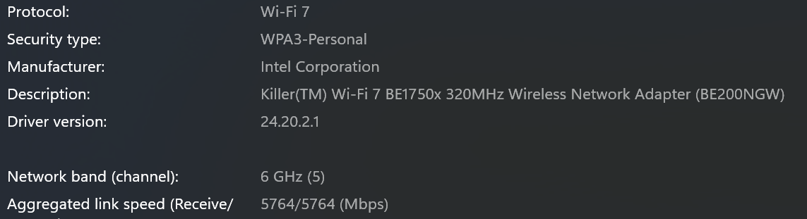

Hi I have 2 x Flint 3’s
One is my main router and the other is running as an AP.
I have noticed that the AP does not use the 320Mhz frequency even though it is selected. The main router seems to work fine.
Is this by design?
MLO seems very inconsistant as well running on WIN11 ENT 25H2
PS I have Intel Killer BE200 wifi adaptors on clients
ChrisC
2
So I resolved this by resetting firmware and setting mlo as different ssid. I now get a connection at 5884MBits/s
