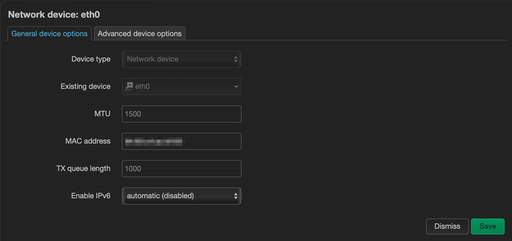

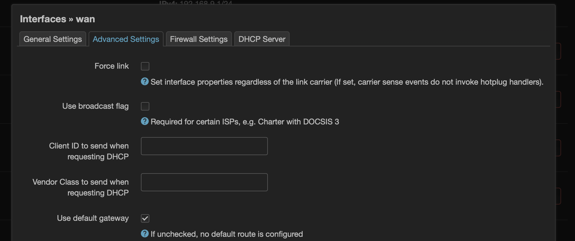

Have you tried enabling "Use broadcast flag" in Luci?
is this IPv4 or v6?

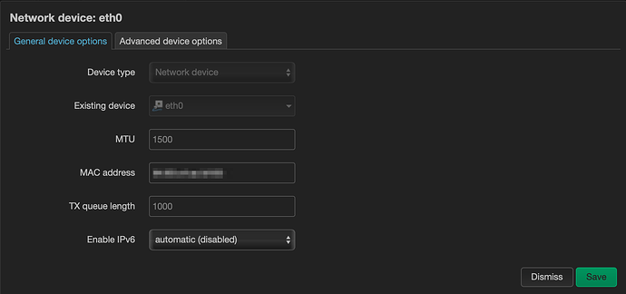

You may also need to tweak the MTU to match your provider
Hi, No, I havn't tried that. I have an existing GL-MT6000 which has worked flawlessly. The settings are the same on both routers (no broadcast flag, 1500MTU)
Will give it a go, but suspect that if it does anything constructive, its going to just be a sticking plaster
thanks

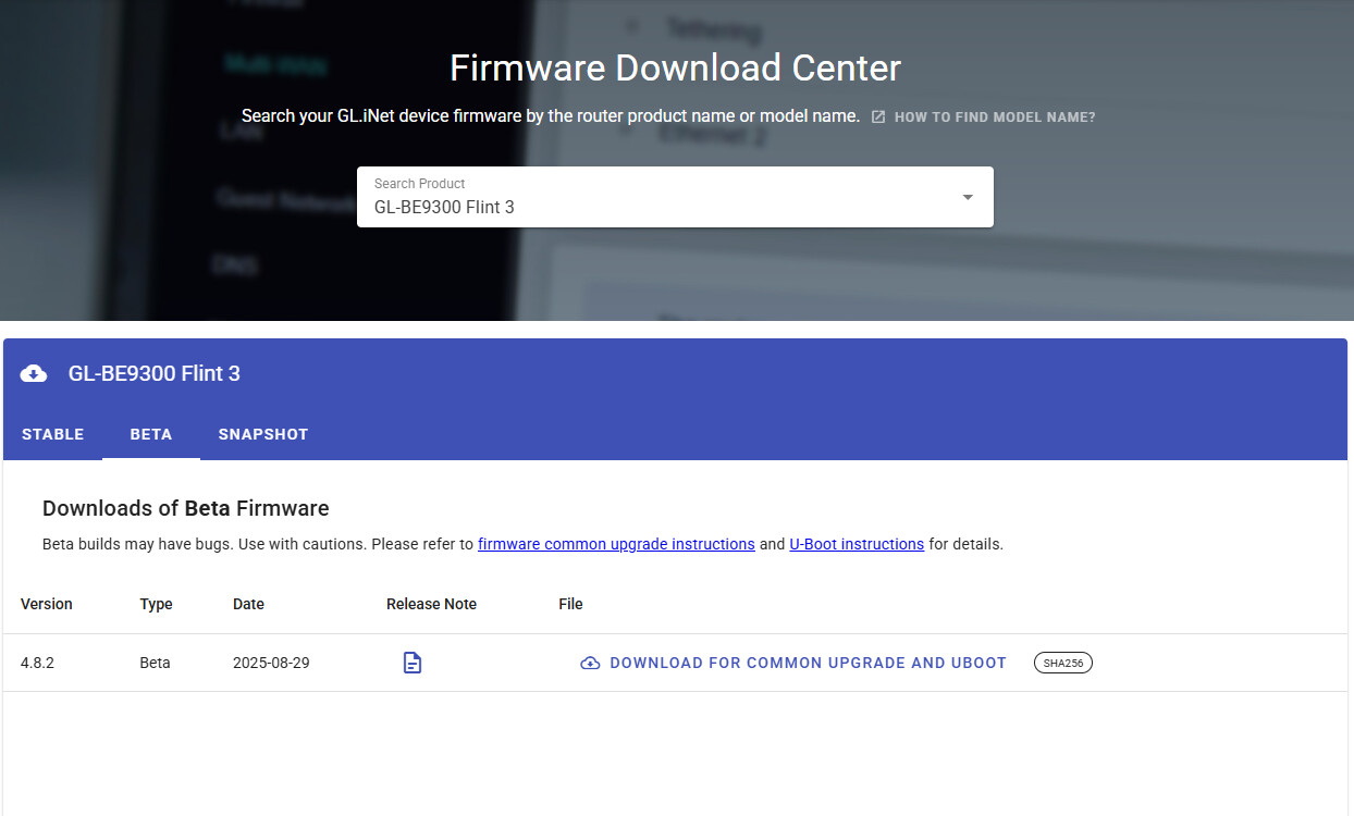

Please upgrade the Flint3 to the latest firmware v4.8.2 (beta), we solved the connection exception issue with Virgin Hub 5 modem on this version:
