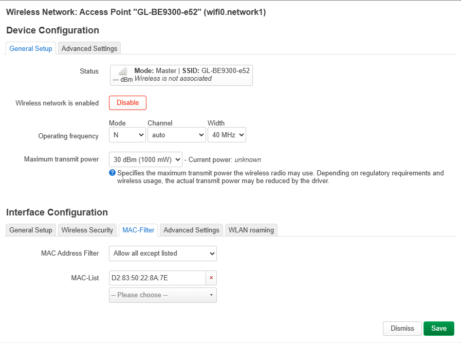

You can use Luci to configure Mac-filter, I have tested it on my side, restart the router, and it is still able to refuse the specified client to connect to.
BTW, I don't have a black/white-list for GL GUI.
Well that's interesting. Because when I set it up through LuCi (except with allow listed only), for some reason it doesn't work after the router reboots. Which might be an interesting issue in an off itself. Could if be due to the fact that the GL.iNet admin panel effectively assumes everything should be set to blacklist (but with no addresses added to it), so it doesn't mess things up when it comes to a blacklist (same as yours), but does when it's an allowlist, but all other interfaces remain blacklist with no addresses included?
You could be onto something. I have the sneaky suspicion this may be be another case of the GL firmware 'doing it's own thing' rather than, IMO, just making the appropriate uci calls that LuCI would use (ref: WG confs, static DHCP).
I don't think one would need to reboot the device. /etc/init.d/network restart should do it, shouldn't it?
It's possible the luci is not fully compatible this is due to QSDK or MTK SDK, I know from the older days with Flint 1 I had to resort using the iw command to set whitelist/blacklist, and this never got saved, so I was forced to use it as a startup command.
I'm not sure if you have access to iwpriv command though.
But I used to use these sets of commands:
^ note only the non karma ones, i guess the karma is not something default in iwpriv.
