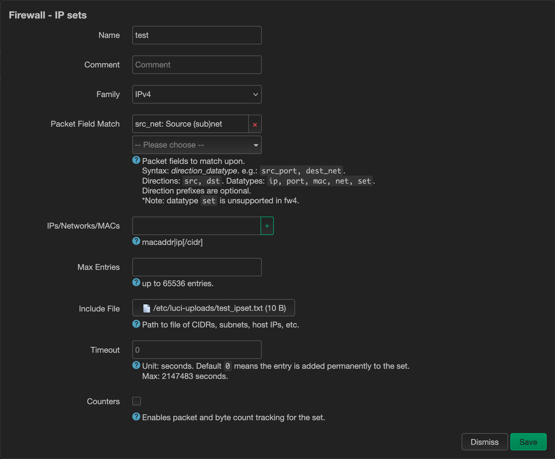

Then, in the IP sets section in LuCI, when I want to match an IP subnet (for example src_net) like in the following screenshot, it can be saved seemingly without error.
However, it doesn’t do anything and the cause can be seen when reloading the firewall via SSH (after saving the IP set).

Sorry, I tested it locally and also reproduce this issue.
Luci is able to save rule, but the rule cannot be loaded into nft firewall, the actual rules cannot take effect.
If possible, please create the rules in Firewall -> Traffic Rules, which support subnet configuration.
If src_net requires kernel 5.6 or above as mentioned, this requirement may not be support at this time. The current QSDK version has no plan to upgraded the openwrt version.
