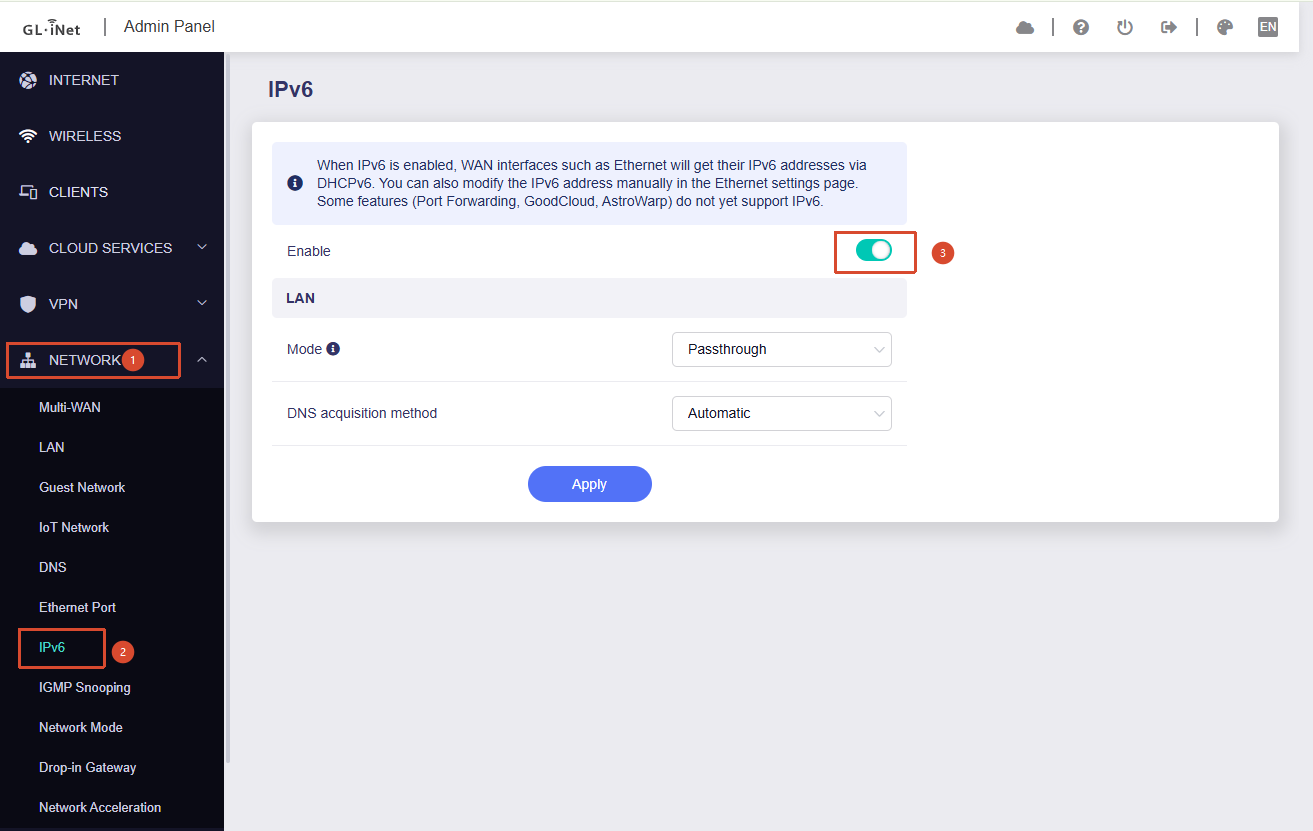

  1. Have you already enabled IPv6 on the Flint 3 under Admin Panel → Network → IPv6?
    We also recommend trying different IPv6 modes to see whether that helps.
