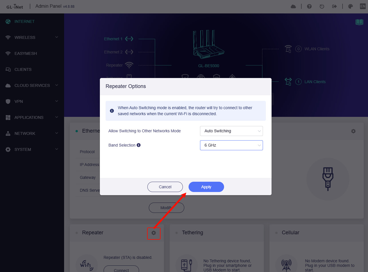

I’m having a similar problem. I want the secondary router to connect to the primary at the fastest speed. It sometimes does this at 6GHz, but often drops down to 5GHz or 2.4GHz and doesn’t ever switch back up to 6GHz to get the faster speed.
Is there a way to get to do that?
I assume your secondary router is BE9300, then you can manually set 6GHz in repeater options.
