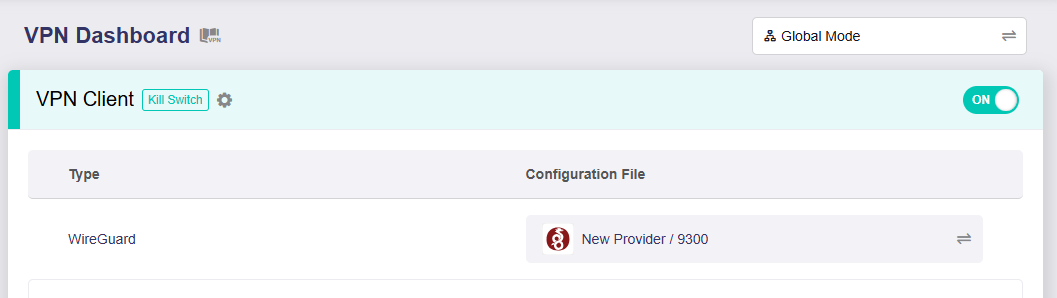

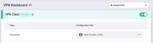

The VPN client is connected to Mullvad and active. I've excluded some devices from the VPN, such as my Chromecast.
On my server, I have Immich, Seafile, and Kasm Workspaces set up to be accessible from outside. However, I noticed that as soon as the VPN client is active, these services become unreachable from outside.

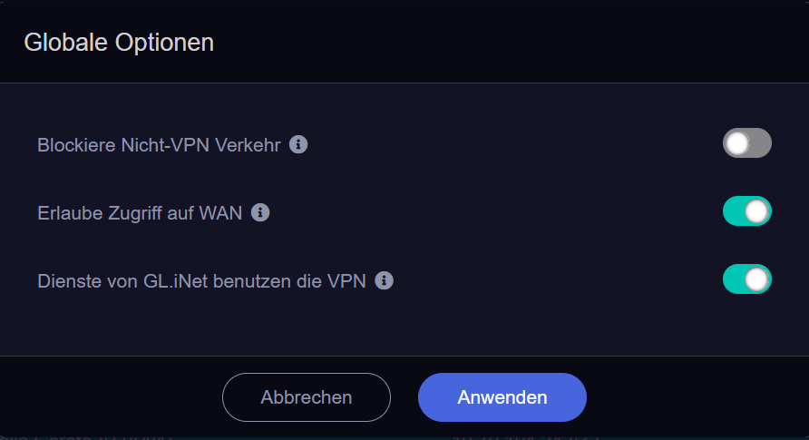

The Flint 3 is currently running firmware version 4.7.13. IP masquerading is enabled for the VPN client, while the other VPN client options are disabled.

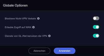

Global options are set as follows:

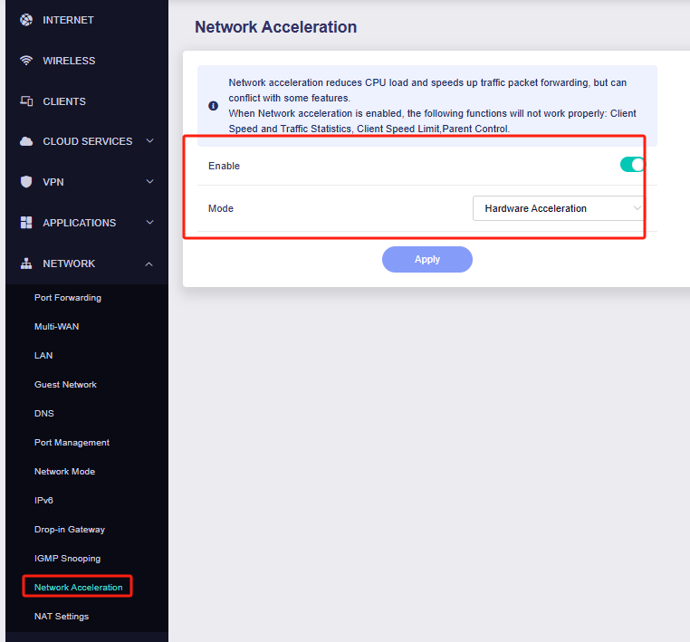

Is your Flint 3's hardware acceleration still turned on?
Are your VPN client and server on the same LAN? Is the device accessing the service from the outside can be any device?
You can try to check the routing table of Flint 3. Manually add temporary port forwarding rules for testing.Check whether the router forces all traffic to go through VPN, covering the public network access route of the server.
Hi alen5193!
At the moment, network hardware acceleration is disabled on my Flint 3. There are a few reasons for that: I read in another thread that hardware acceleration may cause issues on Qualcomm-based models (at least currently). Also pushing down the cpu temp is one reason. In my case, however, I didn’t notice any difference in behavior — the external services were still not reachable, even when the VPN client was enabled on the Flint 3.

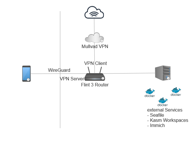

What is your network topology like? Could you please re-describe it or draw a simple diagram?
I would like to try to simulate your network topology to test.
Hi Alen!
Okay, I'll try.
Phone is on mobile network connects via WireGuard to Flint 3 acting as WG Server. Flint is VPN Client connected to Mullvad VPN via WG. Server running docker containers - part of them externally reachable and setup with Nginx Proxy Manager and internally on AdguardHome, so I use FQDNs locally and remotely. Server on local network uses Flints VPN connection to Mullvad and got a Mullvad IP. All Flint's clients - no matter at home or remotely connected - use Mullvad VPN IP.
This is exactly a copy of what I had on Flint 2. It used to work. Now it doesn't.
I'm afraid there's no better way to describe my setup.

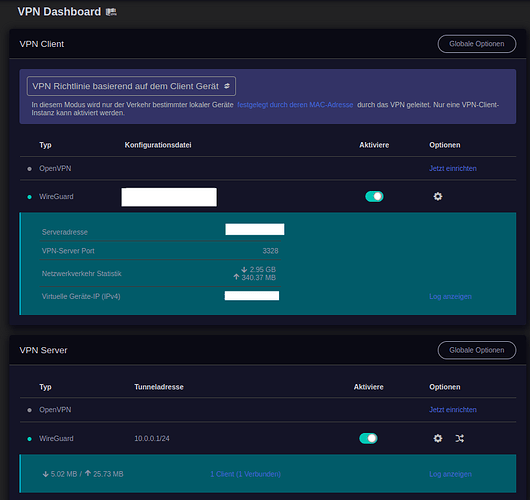

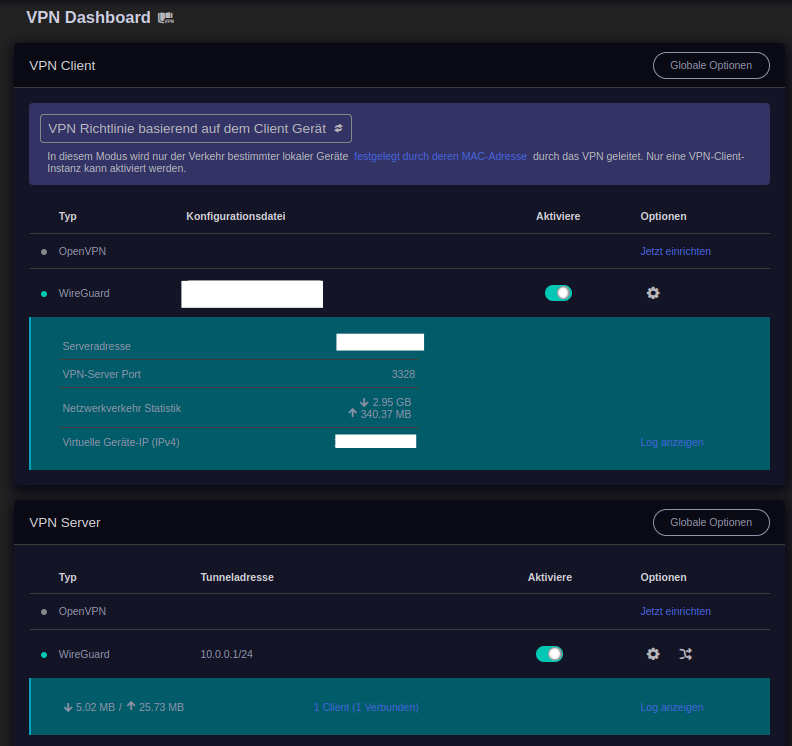

To clarify your question: yes, my Flint 3 was indeed running firmware version 4.7.13, as shown in the screenshot I previously shared. I haven't tried flashing version 4.7.14 yet.
