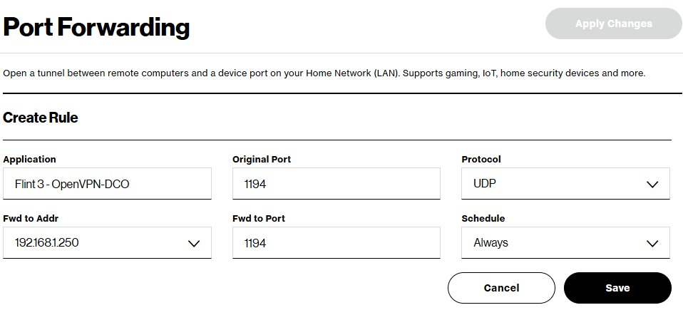

I've tried it with being set as UDP only and Both (TCP & UDP), and still no connection is made. The Port Forwarding Rule exists on Router 1 (Verizon FiOS G3100) and is set as follows
I even put the IP address of the Flint3 (which is static: 192.168.1.250) in the DMZ, and still no connection on Port 1194. However, all other services and port forwarding are fine. I even tried using a different port for the sake of it, and still nothing.

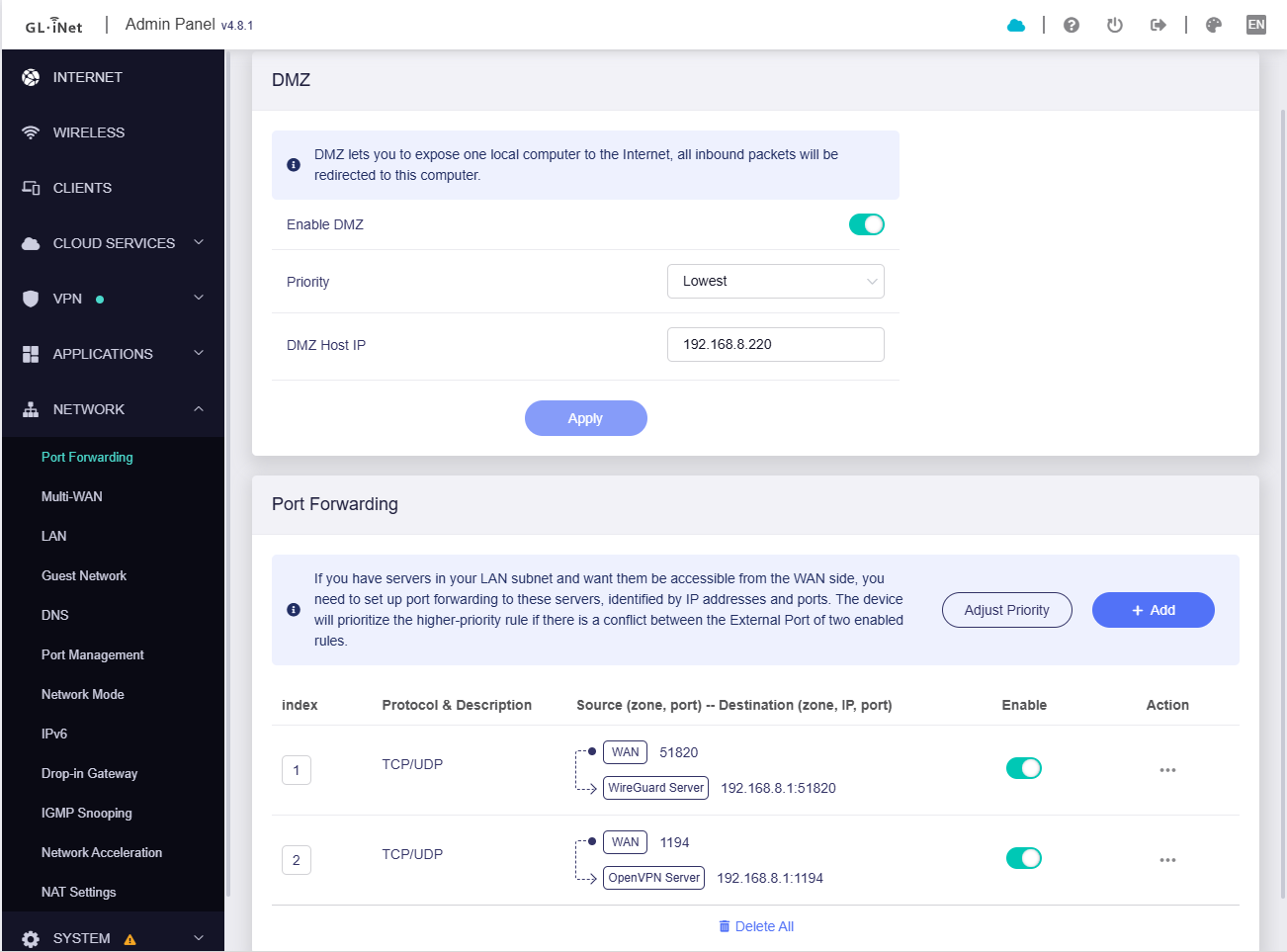

If DMZ is enabled, neither WG nor OVPN can connect, I will submit this issue to R&D, I think it is the DMZ feature issue, it affects the port of the router local services (192.168.8.1).
If you must need to enable DMZ, you need to configure it as follows, adding new port forwarding rules, in order to make the router local services (192.168.8.1) occupy port 1194 and 51820, and set the DMZ level to the lowest.
If DMZ is not required, you can temporarily disable.
This worked. However, a few things...
  1. The DMZ setting needed to be set up lowest priority
  2. Port forward rule needed to be set. I modified to only use UDP and that worked fine.
  3. The only port/service that had issue was OpenVPN on port 1194 on the Flint 3. Wireguard connected fine. Further, I have another OpenVPN server (non-DCO) configured on my NAS at port 1195 and that also connected without issue.

Sorry, I would like to confirm one point, the WireGuard connection tested in my router, and it does not work if I did not add the port forwarding rules and DMZ priority lowest.
Could I check it with your Flint3 WG server again, in the GoodCloud remote?
I'd have to turn Good Cloud back on. I only opened the ticket because OpenVPN wasn't connecting. Everything else was fine and I didn't have port forwarding at all, but priority lowest wasn't set.
What I notice now, is that MLO isn't stable and I lose connection a fair amount when connected to MLO.
I remember that I tested the OVPN client on my router after setting up port forwarding (1194) + DMZ lowest on your Flint3, and no problem.
But the OVPN profile has been deleted and I cannot verify it again.
If you have shared Flint3 to me, I will verify the connection problem with OpenVPN server again.
If you have set up port forwarding (1194) + DMZ lowest and there is no problem with the connection of OVPN server, this is workaround solution, the issue has been submitted to R&D for inspection and repair.
