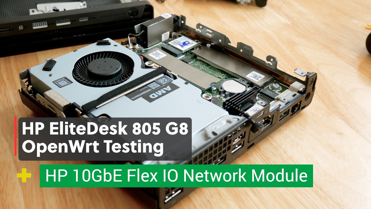

You could always get a something like NUC & drop OWRT x86_64 on it if you don't mind the power draw. Check this out:
Yeah, my current router is a HP SFF running OpnSense, I was considering downsizing to a SOHO router whilst upgrading to WiFi 7, hence the Flint 3.
