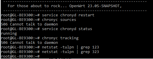

Chrony appears to be broken on the Flint 3. Noticed that my time was WAY off and initially went down the NTP rabbit hold until I was told that is was replaced by CHRONY in this build. Well, it appears that chrony is acting up as the chronyc command can’t talk to the daemon. Is this expected behavior?

Nothing for ps or logread, but did get this for chronyd -d
root@GL-BE9300:~# chronyd -d
2026-01-20T14:31:07Z chronyd version 4.4 starting (+CMDMON +NTP +REFCLOCK -RTC +PRIVDROP -SCFILTER -SIGND +ASYNCDNS +NTS -SECHASH +IPV6 -DEBUG)
2026-01-20T14:31:07Z Fatal error : Could not get user/group ID of chrony
Searched /etc/passwd and /etc/group. No entry for chrony.

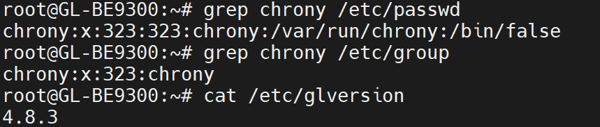

We checked the Flint 3 on v4.8.3 firmware, and the chrony user and group are added correctly by default.
It seems that something else in the router mistakenly deleted the chrony user and group.
You can try reinstalling chrony-nts using the following command; it should automatically recreate the user group.
