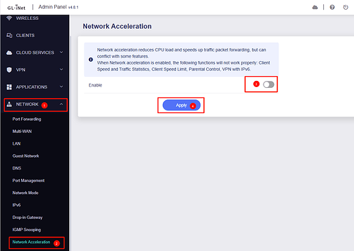

how did you disable hardware acceleration?
Here you go
ic, doesn’t exists in AP mode
Traced the issue to the VPN, it blocks the connection when it’s on so I need to look into why it’s blocking this connection?
  1. In the GL GUI, switch back to router mode, then disable network acceleration, and switch back to AP mode.
  2. In SSH, execute the command directly to disable the network acceleration:
uci set ecm.global.enabled=0 && uci commit && reboot
after rebooting, execute uci show | grep ecm, and check ecm.global.enabled='0', 0 is disabled.
