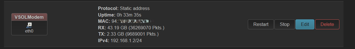

I have Flint 3 on Stable Firmware ( 4.7.14 ). I just added via Luci an interface so that i can access my bridged mode ONT ( on 192.168.1.1) for access.

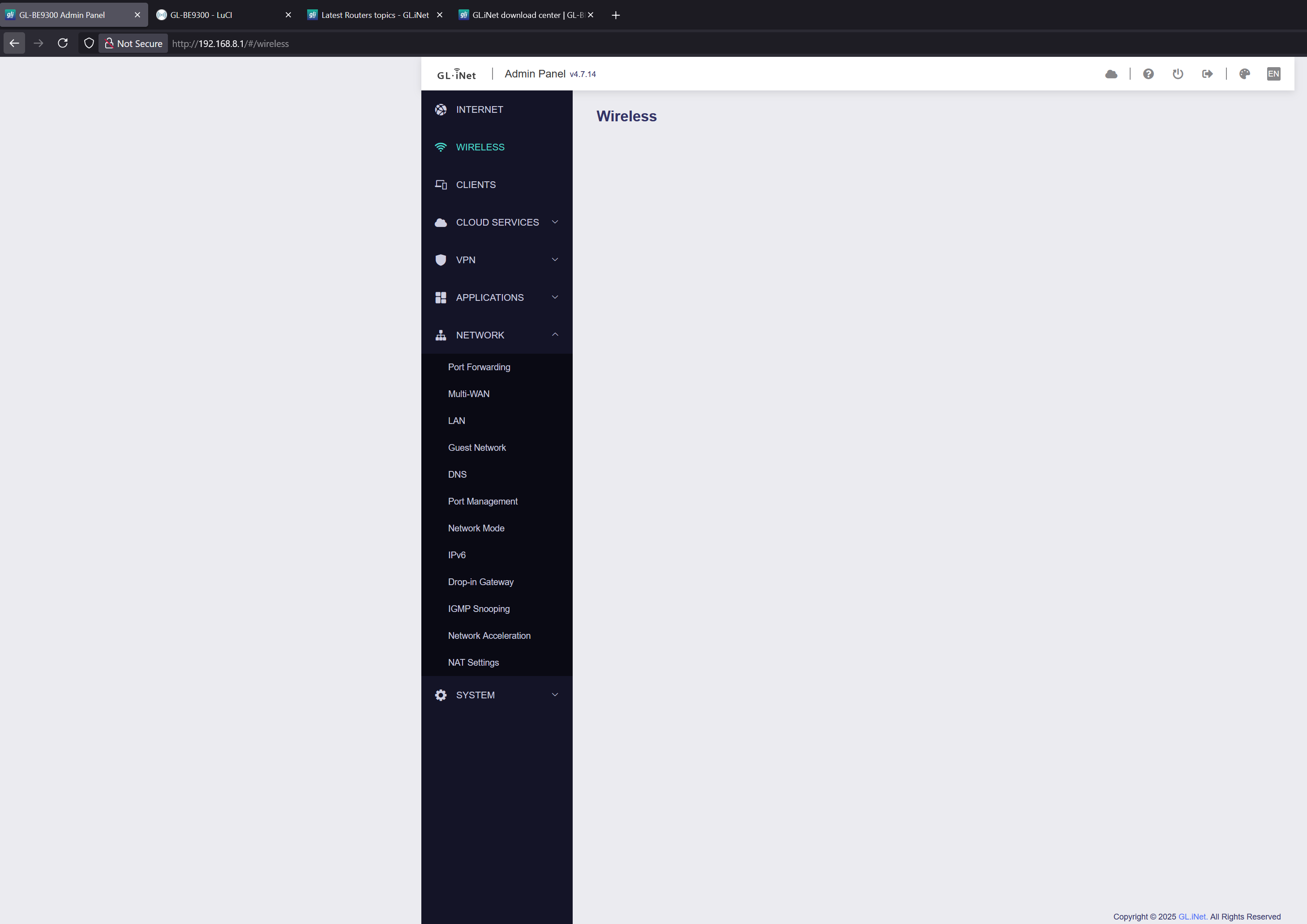

I notice now that the Wireless Page in Admin Panel is not showing anything but i am able to see the active leases via Luci status page.
Yep, getting same even after changing browser or trying incognito mode.. do i need to re-flash or try reset to factory settings.
The router and my Laptop too has been restarted at least 2-3 times since the interface addition.

Can someone too try it and report it ? Just need to add an interface like i have done in 1st post.
BTW i tried it.. even tried edge browser (never used it to connect to 192.168.8.1) cleared it's all time browsing data and then connected still wireless page is showing blank.. will try reset before taking backup of settings.. shame this is a pain as i will have to set my PPPoE and wi-fi settings again if i try to see if it's reproducible issue.. and family all devices will have to disconnect and re-add so i can only try this when internet isn't required which is very odd time.
Update : This is Strange behavior.. I did backup and reset firmware and deleted all settings and data and rebooted.. it still was in 4.7.14 setup as a new router with my PPPoE dialup , installed luci , added the interface to access my ONT and rebooted and now the Wireless Page is coming up perfectly fine as if this issue did not exist.. but still strange that it did that earlier.
