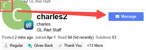

    If possible, could you send us the AmneziaWG profile that is not working properly via private message so we can check the parameters? Please remove any keys or other sensitive information before sending it.
Thank you for your support and understanding.
How to send private messages:
