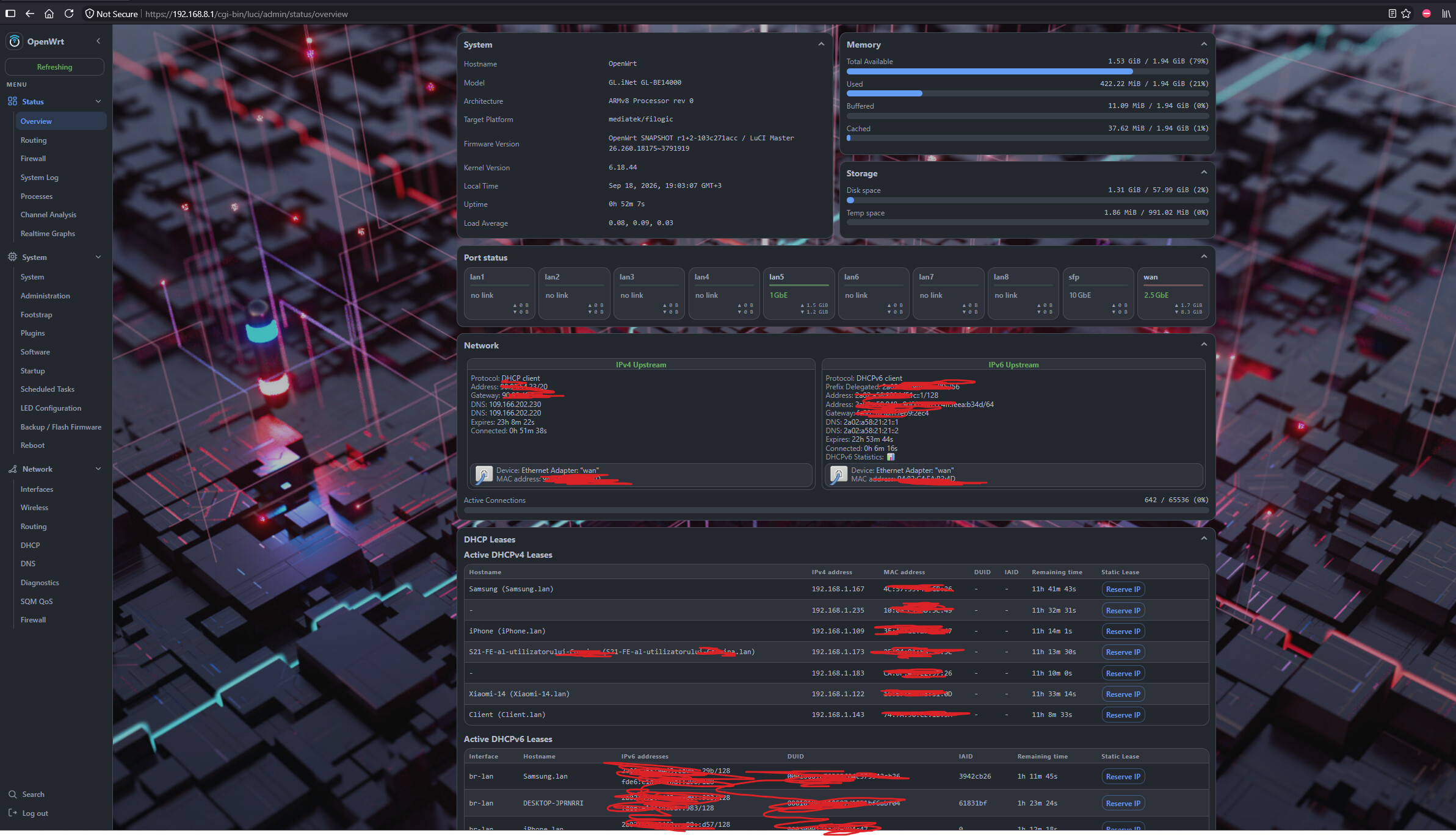

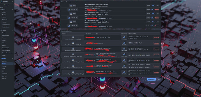

ive compiled a few builds and have a few fixes included, latest build is here with mac fixes for gmac1. Release Flint 4 (GL-BE14000) OpenWrt Test Build – GMAC1 MAC Fix · DiGz-Au/Flint4-build · GitHub
  • Complete Motorcomm YT9224 switch support -
  • YT8824 PHY package support -
  • Fixed 10G USXGMII switch link support -
  • YT922x 4-byte DSA tagging -
  • MediaTek PPE hardware flow offload support -
  • YT9224 hardware bridge forwarding -
  • MT7996 WED support -
  • MT7988 wireless offload firmware -
  • RTL8261C PHY firmware probe fix -
  • GL-BE14000 production device-tree fixes -
  • GL.iNet Panel UI - Touchscreen rotation fix -
  • LuCI - SQM / CAKE support -
  • GMAC1 factory MAC address fix
Nicely done repo build there cheers, @DiGz_Au, I'll keep a close eye on it and have a copy locally now
im running it now and its pretty good. no issues just a couple of little things like the blogic feed coming up when updating apk. nothing to control the screen from luci is another thing id love to implement. for now its options are easier to change via ssh

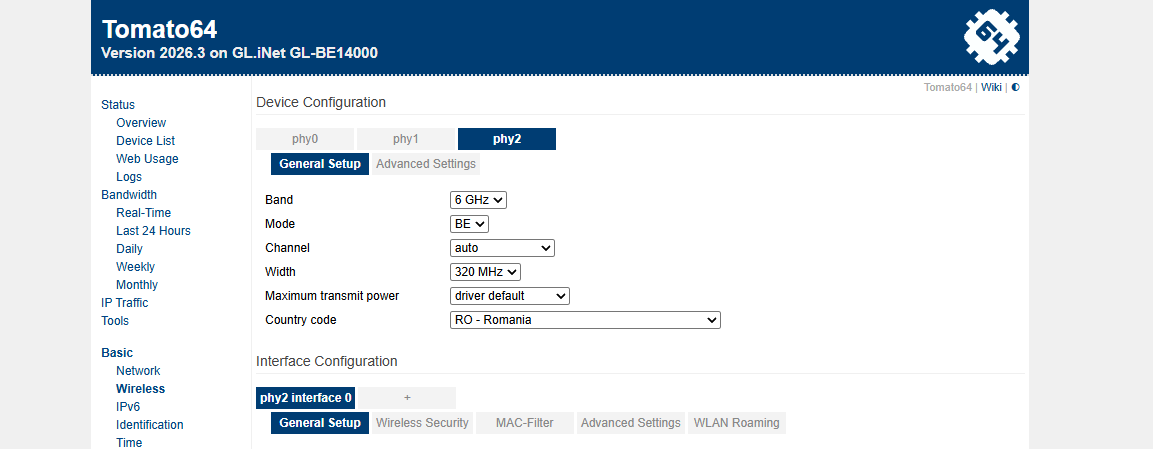

Unto further reading, some reported to have no phy for 6ghz, but they confirmed that it only becomes visible if the country settings are correct, some countries don't support the full 6ghz band, I'm not sure if that is something you also are seeing in the mtk sdk, this however are completely different implementations with OpenWrt as base.

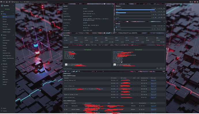

I just wanted to say a huge thank you for your vanilla OpenWrt test build for the Flint 4 (GL-BE14000), especially with the recent GMAC1 MAC address fix. I've been testing it out, and it runs incredibly well—honestly, it feels much smoother and faster than the official GL.iNet stock firmware. Excellent work, and thanks for supporting the community with these builds! [1]

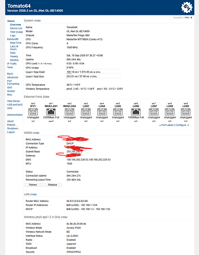

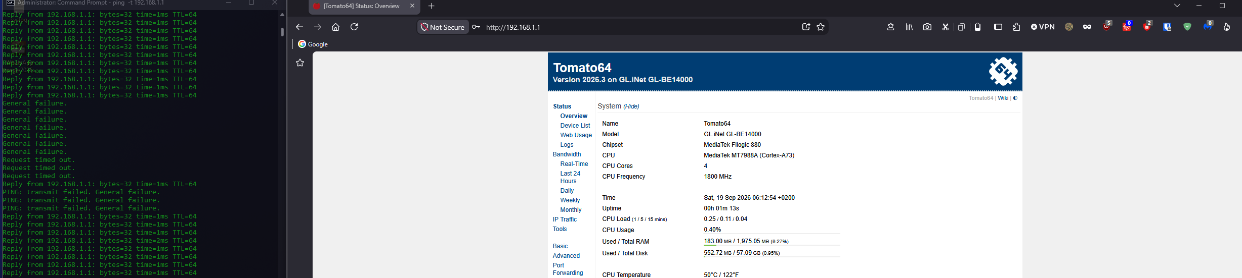

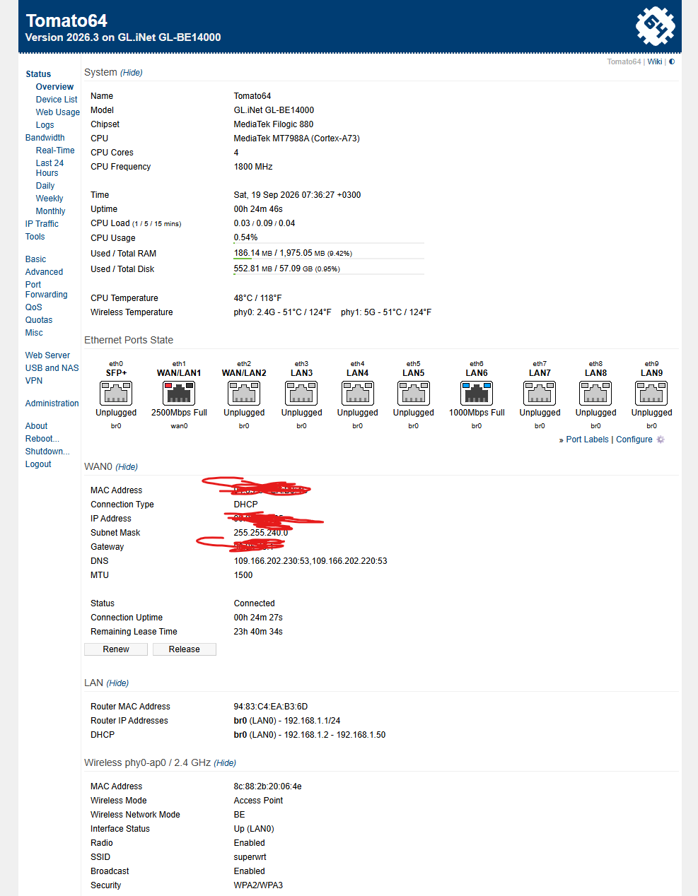

Hi everyone,

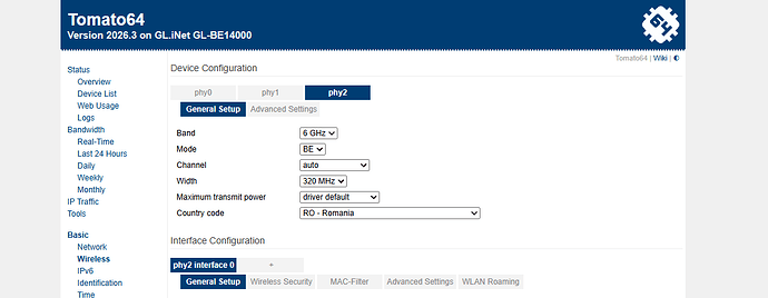

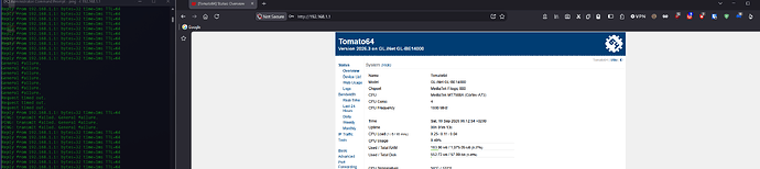

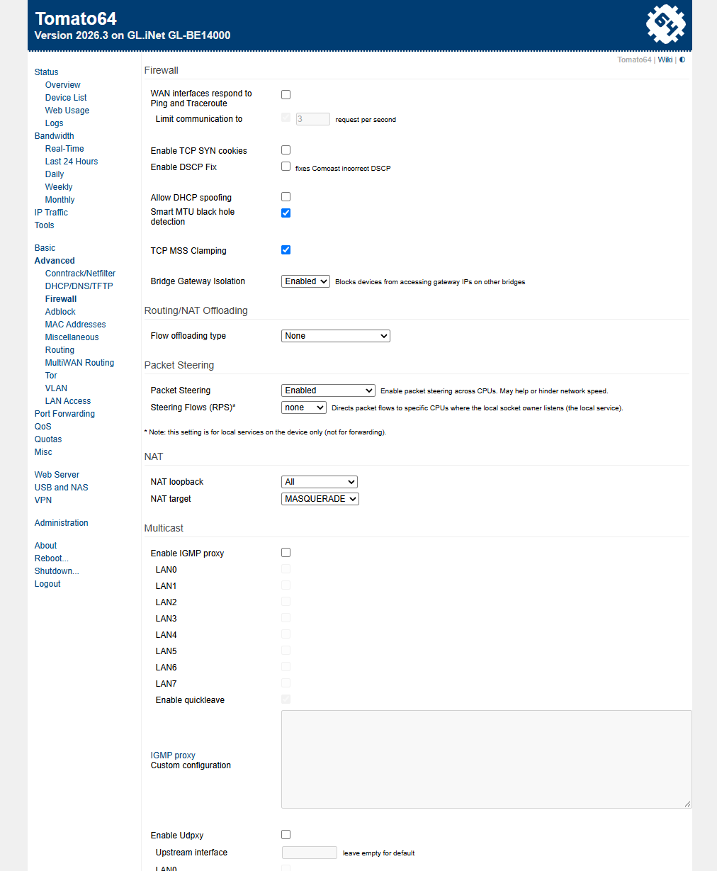

I wanted to share that I successfully flashed the Tomato64 firmware (Version 2026.3) onto a GL.iNet GL-BE14000 router (powered by the MediaTek MT7988A / Cortex-A73 chipset).
Crucially, the installation and transition were done directly from DiGz-Au's unofficial OpenWrt test build (Flint 4 OpenWrt Test Build – GMAC1 MAC Fix) available here:
The entire upgrade process from that specific OpenWrt build to Tomato64 went completely smoothly without any flashing errors or issues.
As shown in the attached screenshot, the control panel loads correctly, the system is fully operational, and hardware resources (CPU, RAM) are being accurately recognized by the new system.
One important remark: The built-in touchscreen is currently non-functional under this build.
If anyone has any questions about the specific steps or the long-term stability of this firmware, feel free to ask below!
