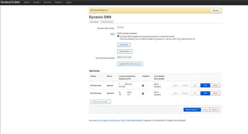

Hello, and thank you for welcoming me on your forum, I have just acquired a Flint GL-AX1800 router, (GL-ATH) It is equipped with the OPENWRT firmware 21.02-SNAPSHOT R163999+159-C67509EFD7 / LUCI OPENWRT-22.03 BRANCH GIT-21.284.67084-E4D24F0 . I am French and know the Open WRT system very little. The WLAN of this router (192.168.10.2) is connected to the lan of my Internet box (192.168.10.1). On the LAN of the Router Flint GL-AX1800, a private network (192.168.1.2 A 192.168.133). I want to be able to have access from the outside to the NAS and Cameras which are on my private network. So I use Dyndns (No IP). So I installed the following DDNS-script-noip 2.8.2-12 package, and configured the Dynamic DNS service. My problem, my 2 dyndns are always stopped, and the update is not done, so impossible access from the outside.
Is it due to a bad configuration on my part? Can you help me thank you in advance. This is an extract from errors in my logs.
