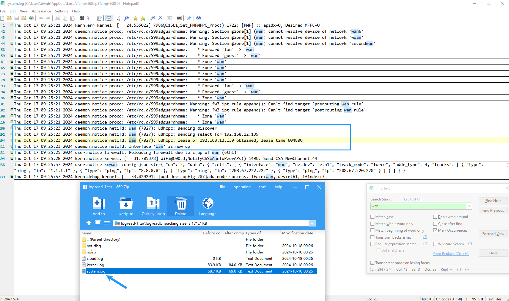

Regarding this issue, please PM me the syslog after it reboots and the Ethernet1 port does not work.

The WAN seems to work ok in the syslog which the PM me.

From logread-1, we can see that the WAN port is up and the connection with the primary router is normal (until the end of the log).
If possibly, try to upgrade to the firmware v4.7.0 beta without keep settings (The printer plugins will be lost).
The logread-2 we can see the WAN have been down and then up (Manual disconnection and reconnection you mentioned), but it always works.

Add interface restart or network restart few seconds after boot to your script. Or better, add a conditional ping that will only fire up the restart command when theres no internet detected.
Offtopic question: What Editor is that you use on that photo?
Notepad3 → Rizonesoft.com as written in the program taskbar :smile:
