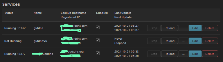

This is unfortunatly buggy if you configure a 2nd DDNS service as a backup for glddns. I noticed this some months ago on all my Glinet routers. Even the service claims the DDNS services are enabled, they wont run. This happens after each update of Glinet fw and each reinstall of luci-app-ddns. You need to go into the DDNS part in Luci and click the manual reload button one time to make the service run.
You can see the issue here:
The third entry in the list is a second to glddns for Duckdns. Even it is enabled, it is not running. Rebooting the router doesnt work too. It only works if you manually click the reload button and then it starts. This needs to be fixed.
There is also this error when you click the reload button:
After reload button it shows it as running, also after router reboot. This works until you update the fw and have to reinstall DDNS again and then it is broken again until you click reload button one time:
