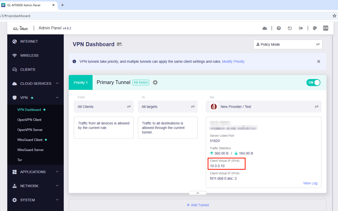

Could you please let us know the current firmware version of your Flint 2?
It seems you're saying that when you manually edit the WireGuard client configuration, you can correctly input 10.0.0.10/24,fd11:db8:0:abc::2/64 .
However, when you start the VPN, the dashboard shows the tunnel is using 10.0.0.1/24,fd11:db8:0:abc::2/64 instead.
Is that correct?
We have tested this on a Flint 2 running firmware 4.8.2, but we haven't been able to reproduce the issue on our end.
