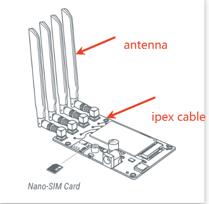

Hi, please ensure the four ipex cables and antennas are connected properly to the M2 board

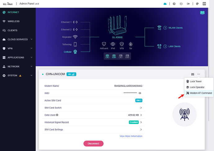

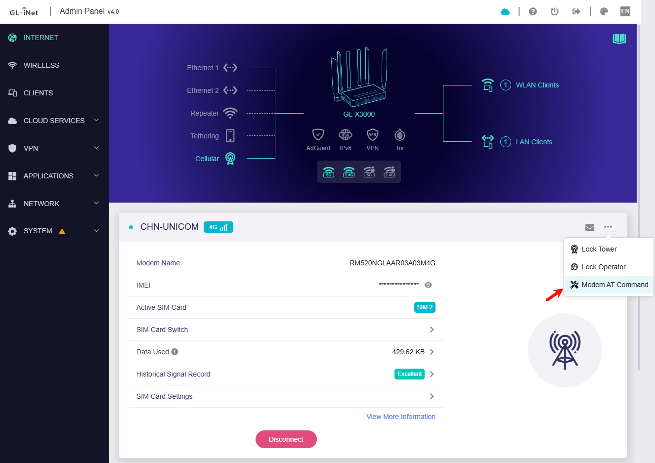

If issue persists, please go to Modem AT Command page to export the debug info and PM me the message.
Thank you, they are. As I said the card/module work fine in windows, just not with the router.
Please go to Modem AT Command page to export the debug info and PM to Cathy.
Modem debug info message sent.
