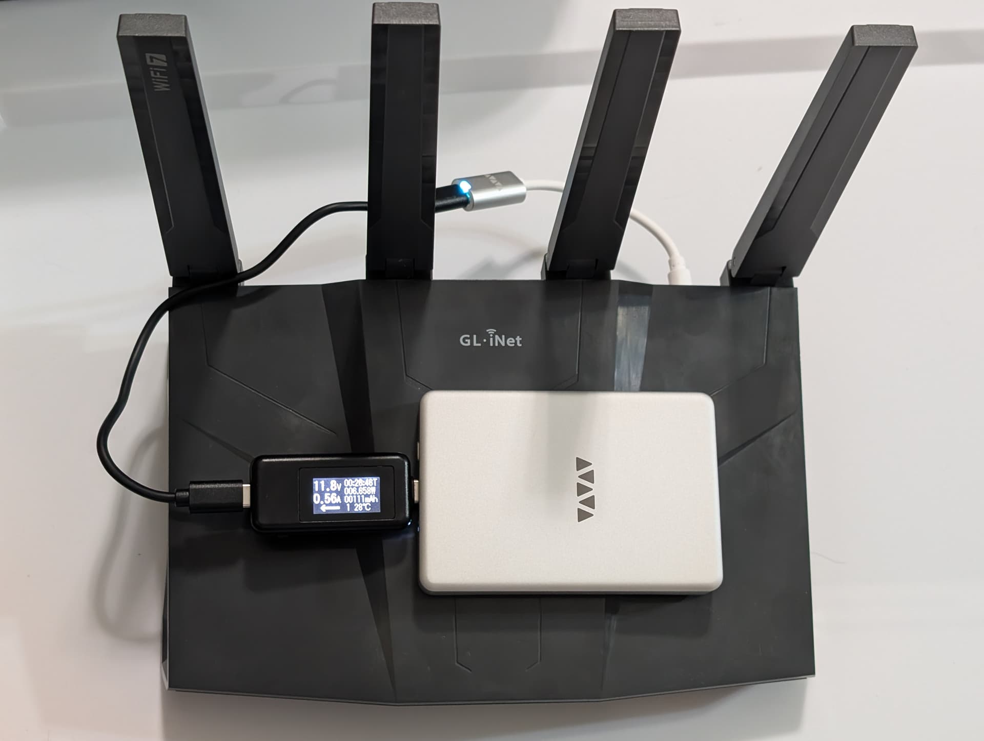

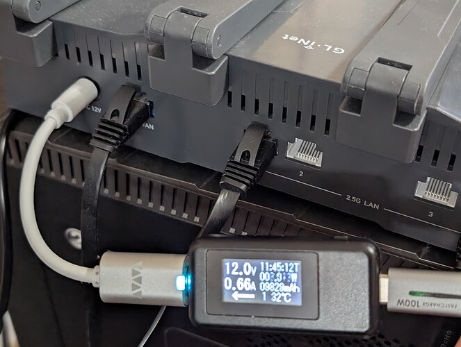

Yes, I didn’t test it for a long time but just for a short test the Flint 3 and Marble worked fine. I even used the Flint 3 on a battery pack! I wrote a blog post about it:
