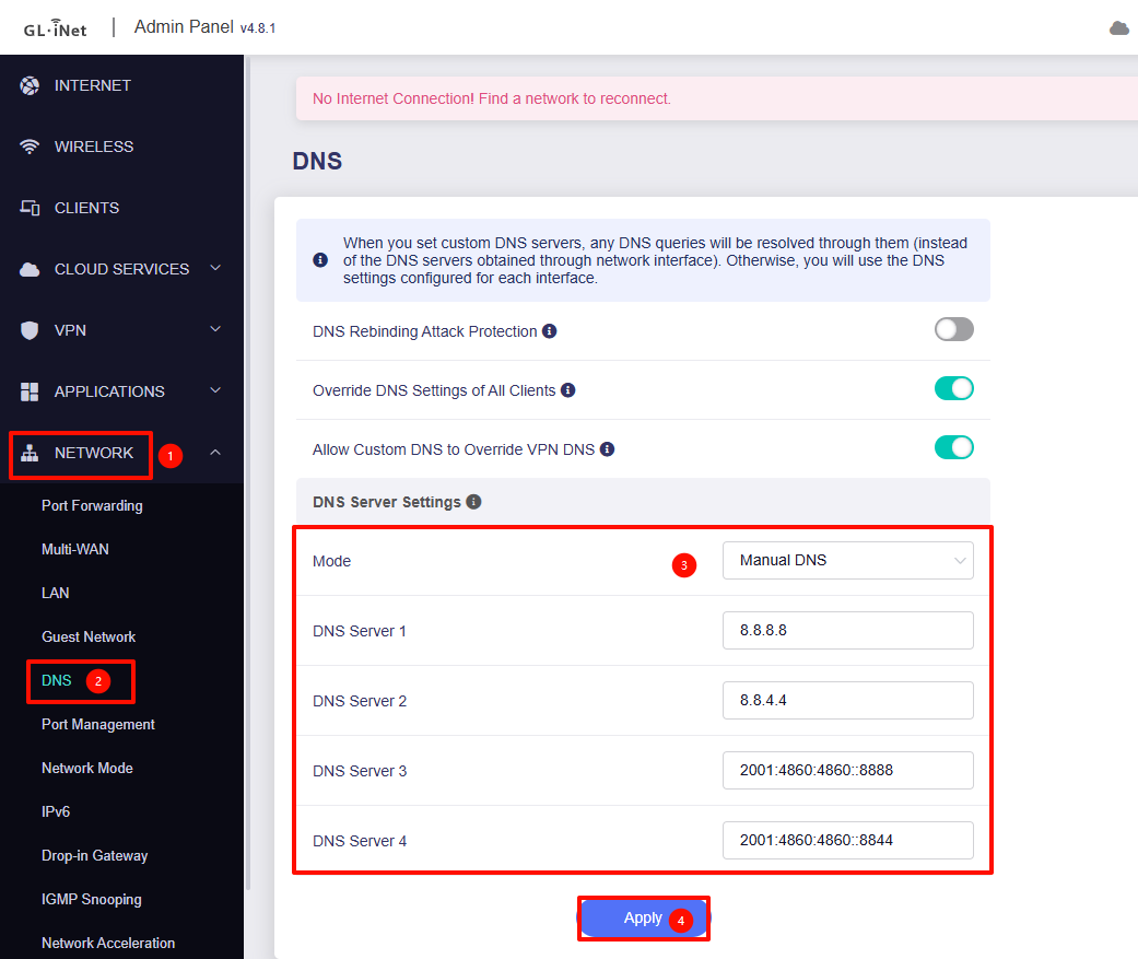

Please try specifying a working DNS server manually in 'Network - DNS'.

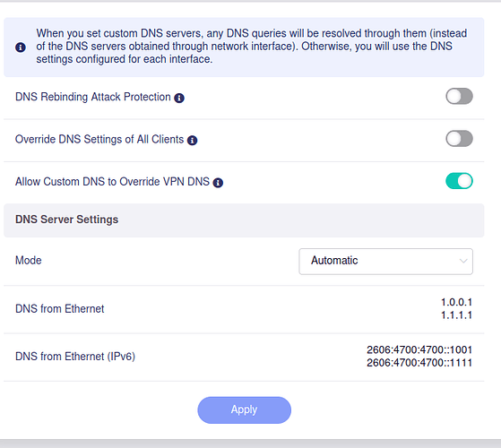

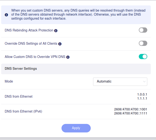

Thank you. I have already set the DNS servers to the Cloudfare ones. I did it through LuCi directly, but it also shows in the GL-inet interface:
I also don’t have Adguard home activated (yet).

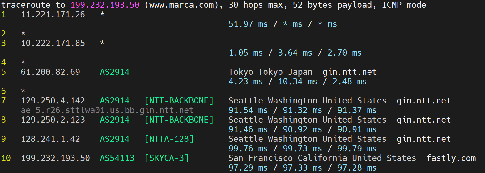

We checked several of the websites you mentioned. Aside from mundodeportivo, none of them have servers or CDN nodes deployed locally in Japan. As a result, accessing them requires traversing international routes (Japan → US).
Considering that globally high-traffic services such as Google and Netflix — both of which operate servers/CDNs within Japan — are accessible without issues, the problem is likely related to congestion on your ISP (NTT)’s international backbone.
A useful way to confirm this is to compare behavior:
  • Websites/services with servers/CDNs inside Japan → generally stable
  • Websites/services requiring transoceanic access → intermittent issues, often worse during evening peak hours
The location you were previously at may have been served by a different ISP, or if the plan had higher priority (e.g., business/commercial service), that would explain why you did not experience the same issue before.

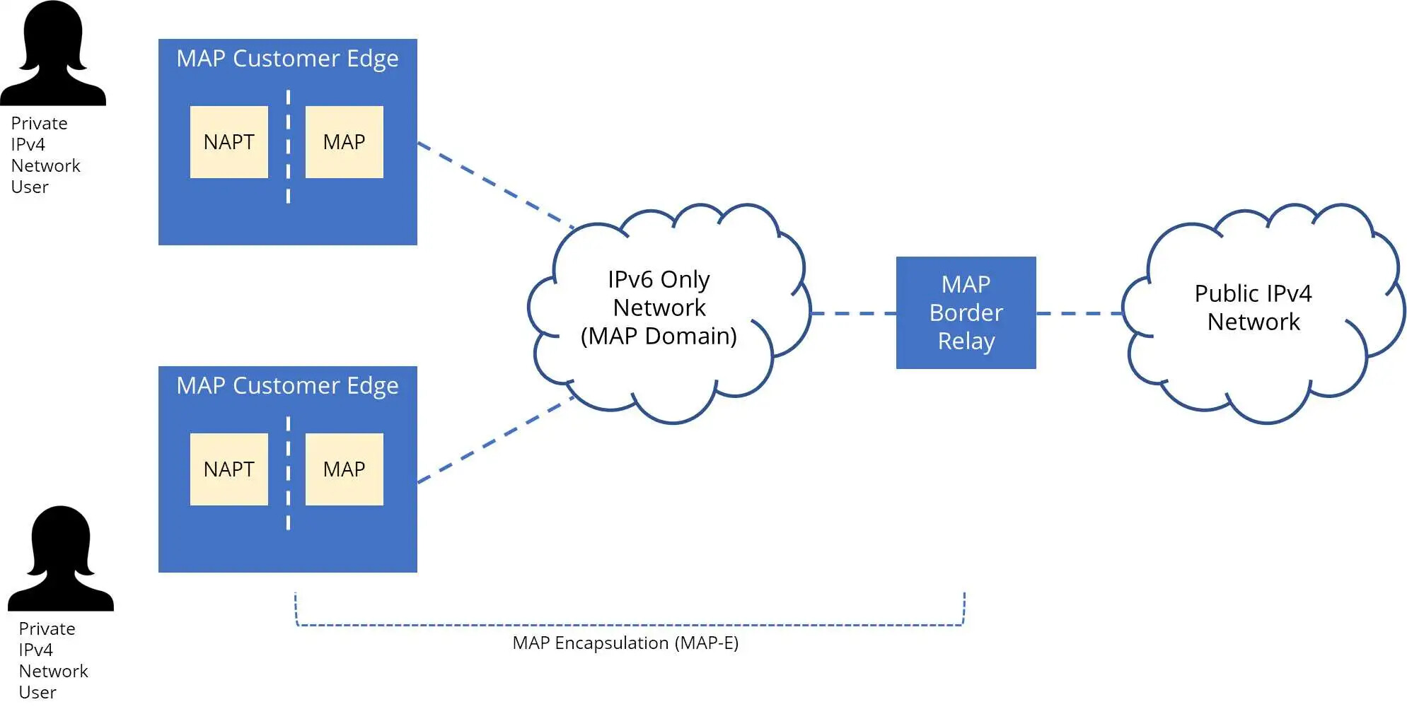

Under MAP-E, all IPv4 traffic is sent to the ISP’s relay server before being forwarded to the destination, so any issues within that relay path could affect performance.

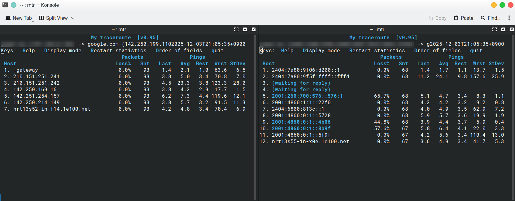

To further validate whether MAP-E is involved, you may consider:
  • Running both IPv4 and IPv6 traceroute/MTR tests to the same destination to identify where latency diverges.
    # On Linux
    mtr -4 google.com
    mtr -6 google.com
  • Checking with your ISP for any known issues on their MAP-E relay or upstream transit links.
  • If available, temporarily switching to an alternative WAN mode (such as PPPoE-only) to confirm whether the performance issue persists outside the MAP-E path.
Thanks for all the details.

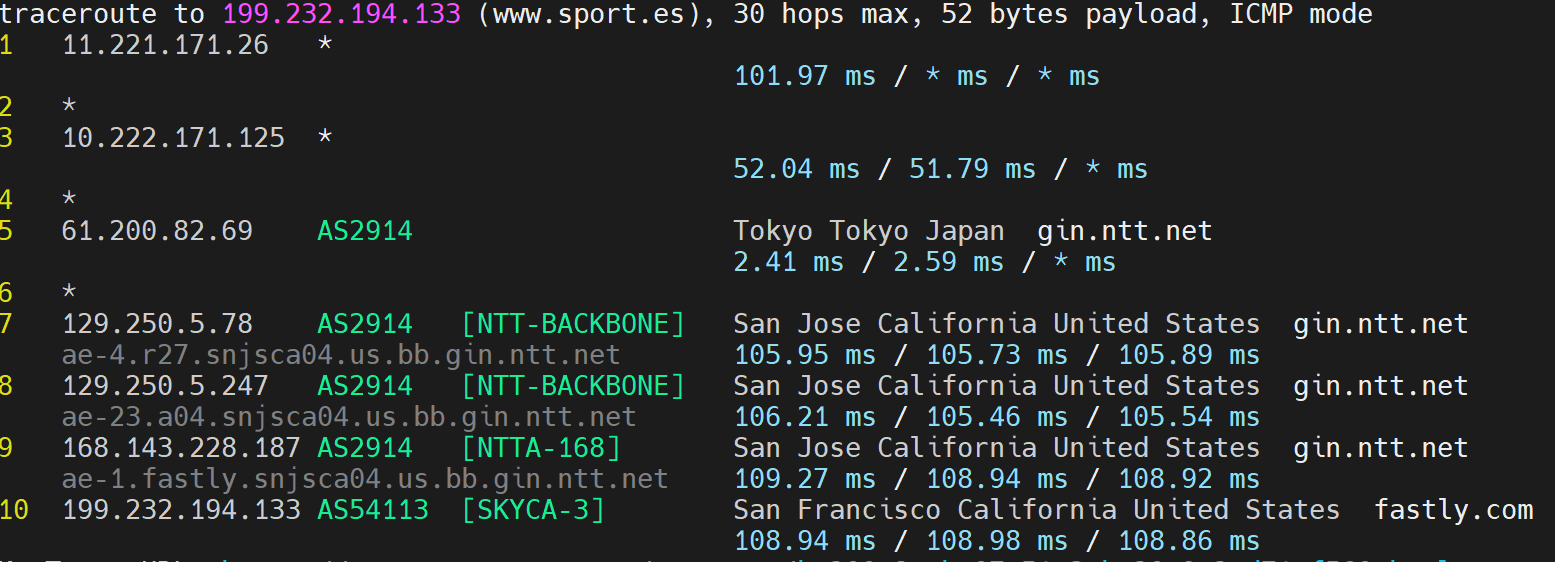

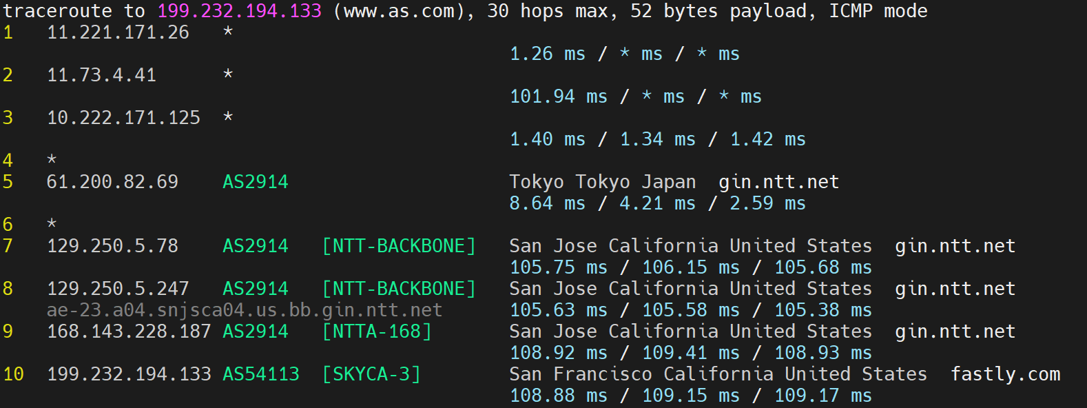

I was searching on my own and found this https://www.reddit.com/r/japanlife/comments/1bdp7p9/any_internet_troubleshooting_experts_not_basic/ I do not remember changing the MTU size but I made sure that both in wan6map interface and lan the MTU settings were blank (so default). I couldn’t find the setting in the wan6 interface.
I am not sure if by chance, the connection got better shortly after. However, it’s still not working well with some slow loading and plenty of hostname resolution issues in my torrent app (through a VPN) and I cannot connect to my workplace’s VPN. Again not sure if that made any change or it was just a coincidence since in the beginning I also couldn’t access my work VPN and it suddenly started working…
I ran the above commands from my computer with the following results (left is ipv4, right is ipv6 both running in parallel)
I am checking with the ISP but I am not having a lot of luck with them yet. One main roadblock is that they don’t consider GL-inet routers as ‘recommended’ or ‘supported’ and their suggestion is to get a different one. I will insist a bit more but otherwise I might have to get one of those at least temporarily after new year to troubleshoot and have a comparison point. As of now they also don’t provide me with an alternative PPPoE entry point yet…
