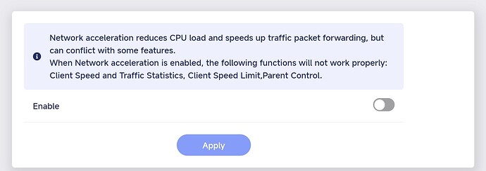

Network acceleration bugged. when is on download speed is lower. deactivated increase a little bit. Also Packet Steering not working at all. active or deactivated is same.

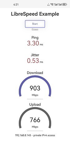

@bruce good news. I think i have fix it. with version 24. Is not that stable... sometimes is 900mbps sometimes 600mbps but better then before.

the third-party plug-ins, and especially for network processing, it probably is interfere with GL codes. Could you try to disable the 'Network Acceleration' first?

But in terms of performance the 24 is superior from what i have seen at last for wifi speed.
