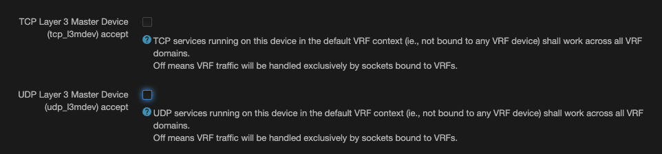

(new options are found under Luci –> Network –> Interfaces –> Global Network Options )

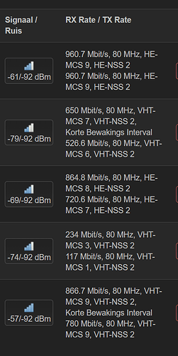

Here's one data point. I wouldn't expect any downgrade just because of a dot release but that's speculation. I'd guess it's be more of a matter of the capabilities of the connected client device by the looks of this WLAN benchmark of 4.8.0-op24:
fine? Did not test the max speed, just several ipads and media players.. all fine.

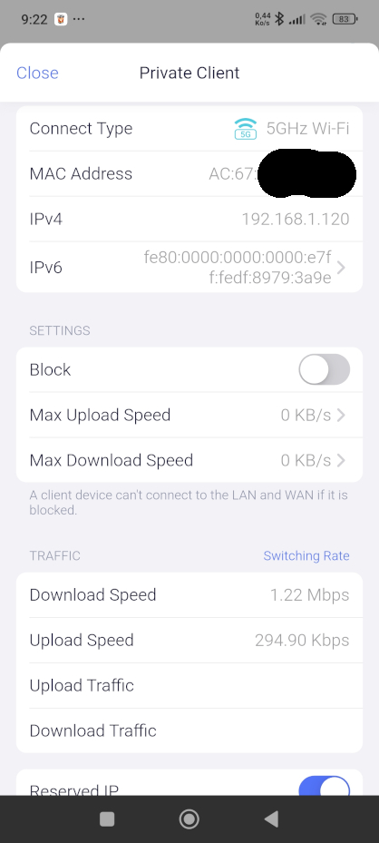

I upgraded from 4.8.0 op24 to 4.8.2 op24. All working fine. But in the mobile app on Android, noting is displayed in the Upload/download traffic section of the clients. The web interface displays all values.
May I know are you referring to the glinet APP?
Please take some screenshot for the APP interface and the Web UI?
Hello Bruce,
Yes it is the Glinet app. Here a screenshot:

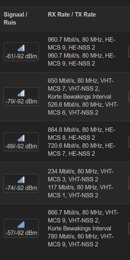

And here the info from webinterface:
Screenshot 2025-09-10 at 09-25-46 GL-MT6000 Admin Panel

How about the display in GL GUI Client page?

Oh, sorry, I misunderstood, I thought it was the clients (media players) able to connect to 5GHz WIFI, but Luci page did not show their WIFI connection status.
