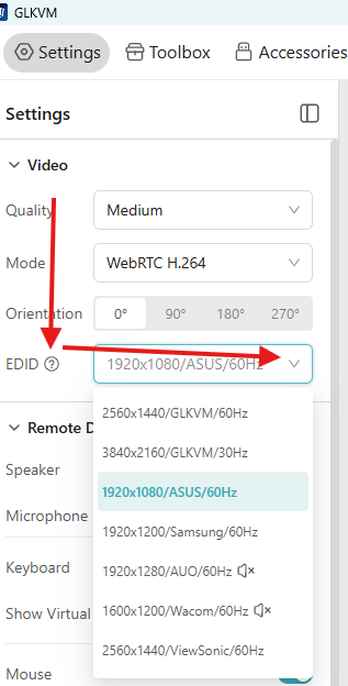

We recommend using the original HDMI cable, and trying different EDID
