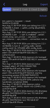

If the issue still occurs after upgrading, could you please provide a screenshot showing the Repeater connection status or the page where the login process gets stuck and export the System Log after the issue occurs, without rebooting the router, and send it to us via private message.

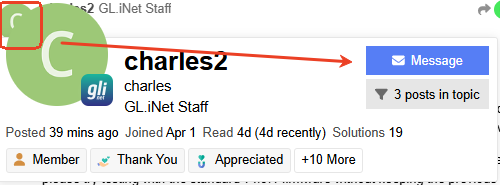

Hi, still no luck with connecting. Has support got an email address as I can't send the logs from the router as it has no internet
We have replied to you via private message.

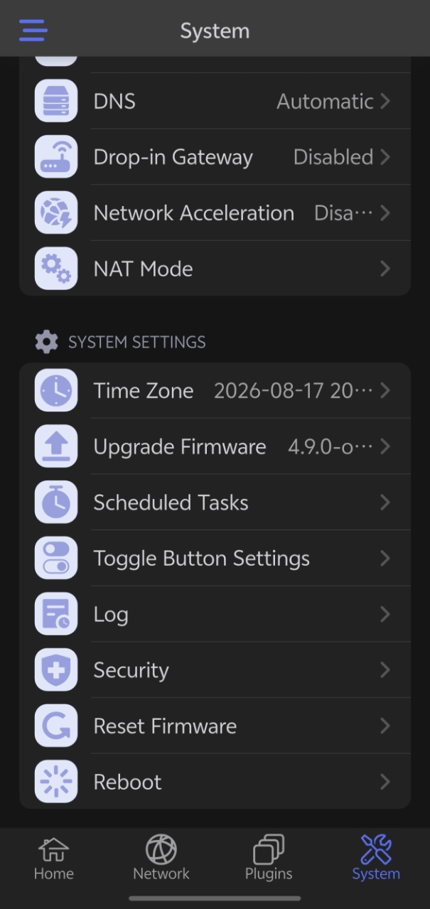

For the logs, you can also use the GL.iNet mobile app to export the System Log from the router and then send the exported log file to us via private message.
