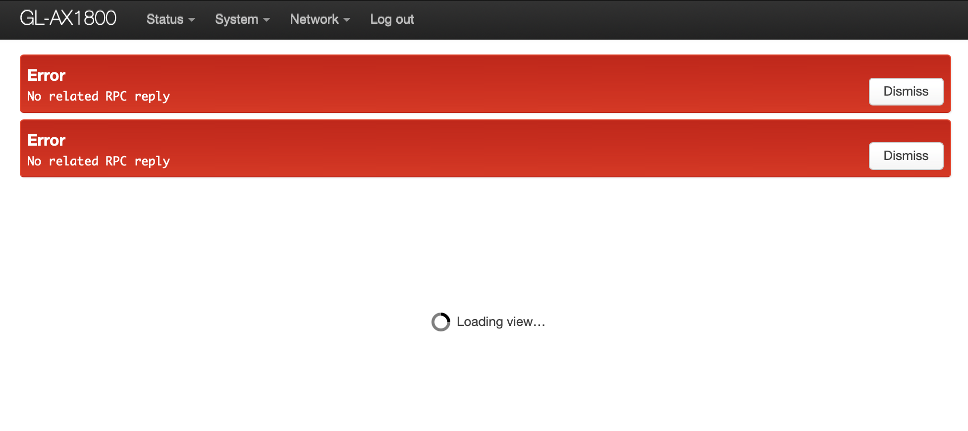

After doing an upgrade on my AX-1800 to 4.6.4 or to 4.6.6 my modem resets randomly every 5,10,30,60 minutes in the logs I have :

Yes, I have router GL-1800AX (Flint)
I currently reset the modem to factory settings and uploaded the latest software version 4.6.6. The modem worked for 24 hours yesterday, but today it reset again.
usbmuxd is driver of iOS USB sharing
It makes sense. To the router, no USB devices are connected. However, the “resets” usually occur when I enter the house -> that is, when my iPhones start connecting to the router.
I have 2 iPhone's with newest iOS 18.
What is the fastest way for me to keep the logs continuous, because every time I reset, the previous logs get erased.
Best Regards

smith
October 8, 2024, 10:09am
9
After install your firmware I don't have access to internet and additionally I can't connect to VPN
Tue Oct 8 09:38:15 2024 daemon.notice netifd: wgclient (15629): Cannot find device "wgclient"
Tue Oct 8 09:38:15 2024 daemon.notice netifd: wgclient (15629): Unable to modify interface: Protocol not supported
Tue Oct 8 09:38:20 2024 daemon.notice netifd: Interface 'wgclient' is now down
Tue Oct 8 09:38:20 2024 daemon.notice netifd: Interface 'wgclient' is setting up now
Tue Oct 8 09:38:20 2024 daemon.notice netifd: wgclient (15843): RTNETLINK answers: Not supported
Tue Oct 8 09:38:20 2024 daemon.notice netifd: wgclient (15843): Cannot find device "wgclient"
Tue Oct 8 09:38:20 2024 daemon.notice netifd: wgclient (15843): Unable to modify interface: Protocol not supported
Tue Oct 8 09:38:25 2024 daemon.notice netifd: Interface 'wgclient' is now down
Tue Oct 8 09:38:25 2024 daemon.notice netifd: Interface 'wgclient' is setting up now
Tue Oct 8 09:38:26 2024 daemon.notice netifd: wgclient (16096): RTNETLINK answers: Not supported
Tue Oct 8 09:38:26 2024 daemon.notice netifd: wgclient (16096): Cannot find device "wgclient"
Tue Oct 8 09:38:26 2024 daemon.notice netifd: wgclient (16096): Unable to modify interface: Protocol not supported
Tue Oct 8 09:38:31 2024 daemon.notice netifd: Interface 'wgclient' is now down
Tue Oct 8 09:38:31 2024 daemon.notice netifd: Interface 'wgclient' is setting up now
Tue Oct 8 09:38:31 2024 daemon.notice netifd: wgclient (16354): RTNETLINK answers: Not supported
Tue Oct 8 09:38:31 2024 daemon.notice netifd: wgclient (16354): Cannot find device "wgclient"
Tue Oct 8 09:38:31 2024 daemon.notice netifd: wgclient (16354): Unable to modify interface: Protocol not supported
Luci is also crashed (screenshot)
UPDATE :
Resets are not caused by software updates. In version 4.6.2, they also occur.
So the cause is either iOS 18 / MacOs 15 devices (Each phone has a different VPN)
Or physical (hardware) damage to the router.
