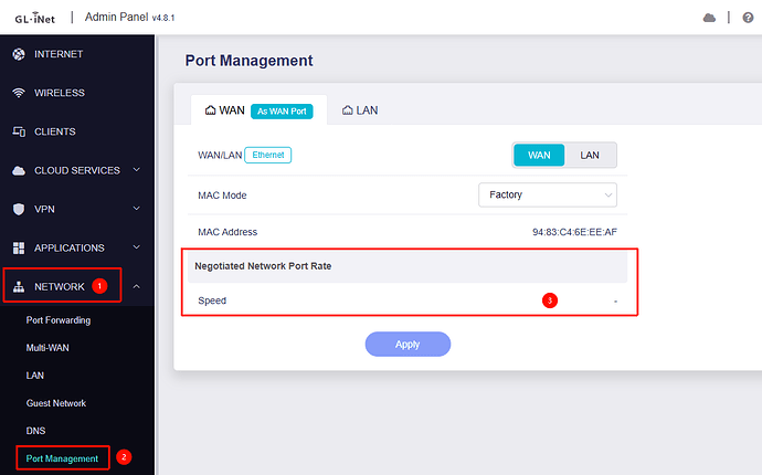

  1. What is the exact device model? I assume it’s the Beryl AX MT3000?
  2. Are you experiencing an issue where the negotiation speed of a specific port is stuck at 100 Mbps? Which port is it?
    You can find the port negotiation speed in Admin Panel → Network → Port Management.
It's a Spitz AX GL-X3000
It's bottlenecking on all wan ports. I don't have a LAN port at the moment to check the LAN
I even tried to change the port 2 LAN to want and still showing 100 Mbps full duplex as seen in the photo
