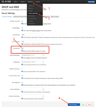

  2. Please enable dnsmasq logs in LuCI -> Network -> DHCP and DNS, then provide the related DNS request logs.
