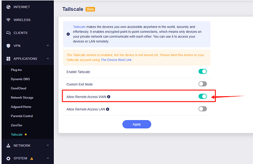

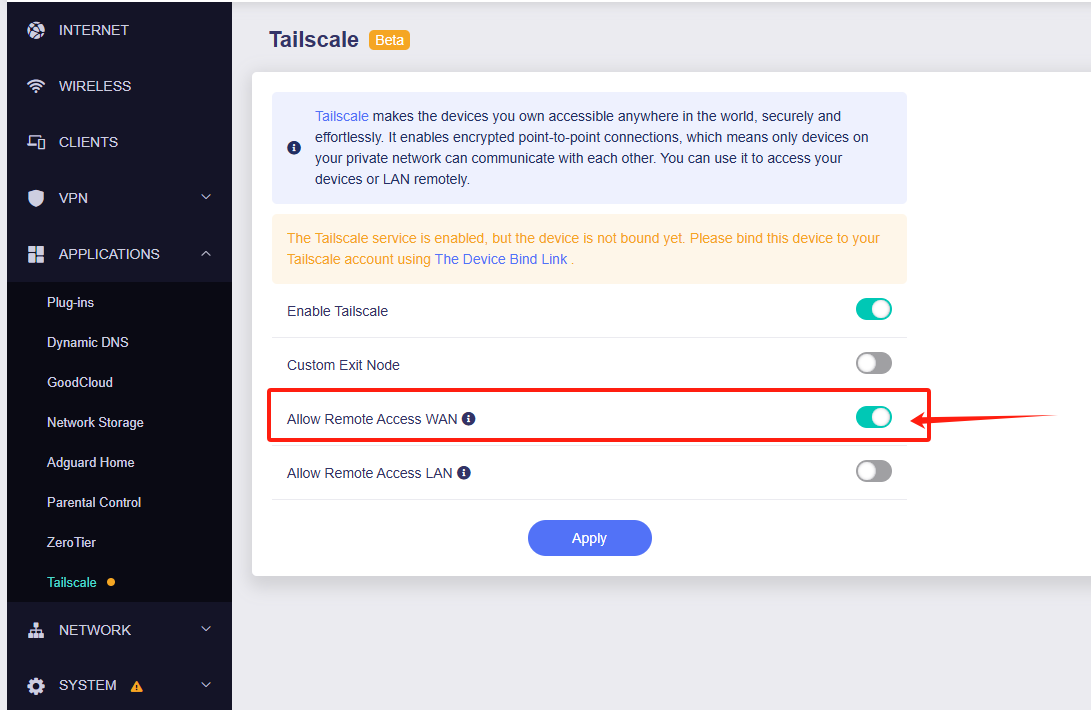

Hi there,
Please find and enable this option on your router.
Hey thanks, for your time and replay,...
I activated the point from your picture but problem still exist. So I disabled tailscale completely, but even then I can't get access to the wan subnet. weired.
I can get access to the local inventary through a cloudflare tunnel, that's not the problem, but it's annoying when you can't solve the problem. :-1:
thx anyway,...

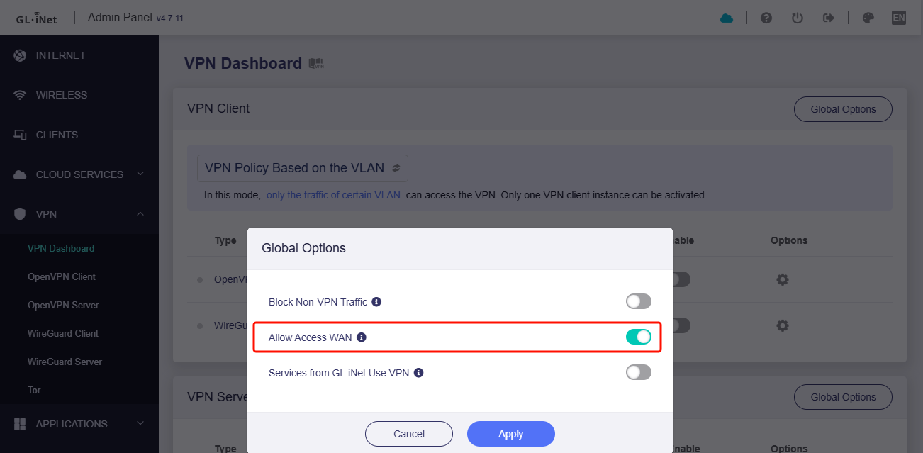

Are you ping from a router's LAN client or another tailscale client?
You can try turning on this option in the VPN panel.
