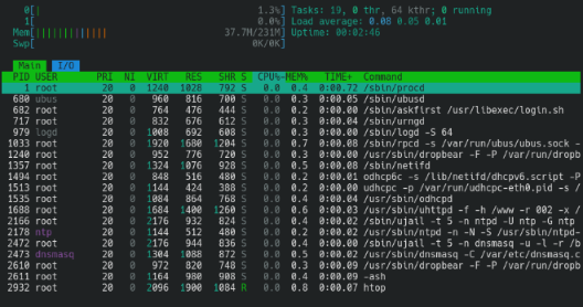

Here's what it looks like when setting up htop to run off /mnt/sdb1:

opkg update && opkg install htop -d opt
root@002:~# which htop
/mnt/sdb1/usr/bin/htop
Before symlinks are in place:
root@002:~# htop
Error loading shared library libncursesw.so.6: No such file or directory (needed by /mnt/sdb1/usr/bin/htop)
Error relocating /mnt/sdb1/usr/bin/htop: mousemask: symbol not found
Error relocating /mnt/sdb1/usr/bin/htop: start_color: symbol not found
< snip >
Error relocating /mnt/sdb1/usr/bin/htop: COLORS: symbol not found
Error relocating /mnt/sdb1/usr/bin/htop: stdscr: symbol not found
Error relocating /mnt/sdb1/usr/bin/htop: COLS: symbol not found
After:

Tested with htop & nano in a 23.05.0 x86_64 VM & a Certa (GL-AR750) v4.3.25-release1. YMMV.
