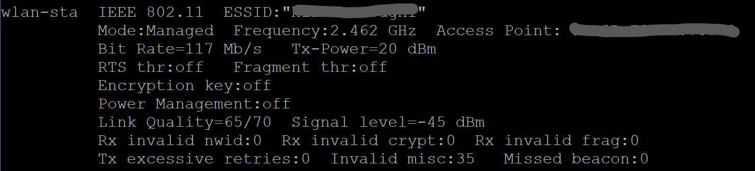

Here is the output of the last setup that I did with country slovenia

Nice throughput…! as you can see on my screenshot and signal quality, I do need to try at higher tx power levels to see if I can improve performance. Already tried a few different antennas. 12dBm wont do.
