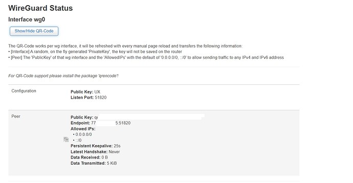

But I can’t get the GL-AR750 to connect. It keeps Yellow, I have no internet but also no error.
Where to start looking?
This is the status I can see. No error but also no data transfer. Look’s like the data is not getting back.
Error somewhere?
