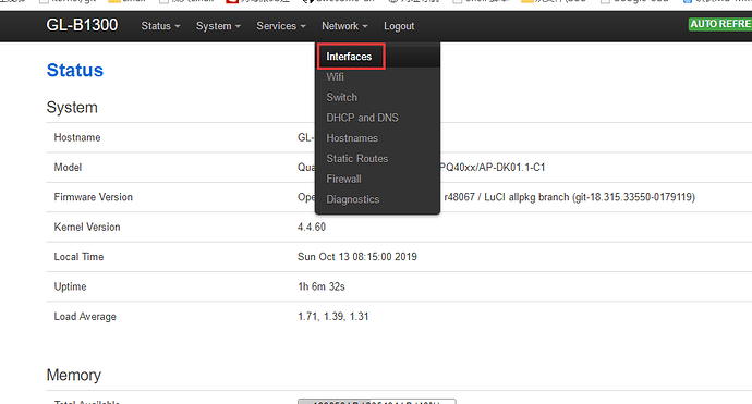

Have you tried setting the LAN IP from Luci?
You can also do it from command line. If you login to the router via SSH, run the following:
sed -i "s/'192.168.8.1'/'100.100.0.1'/g" /etc/config/network
Reboot the router and it should be in the new range you want :slight_smile:

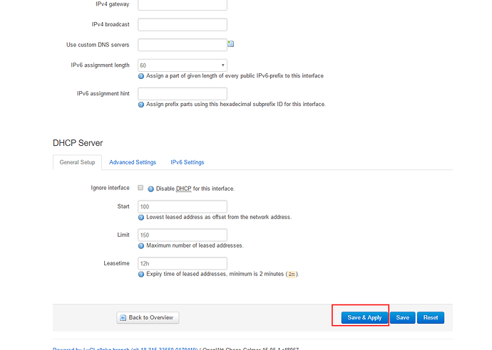

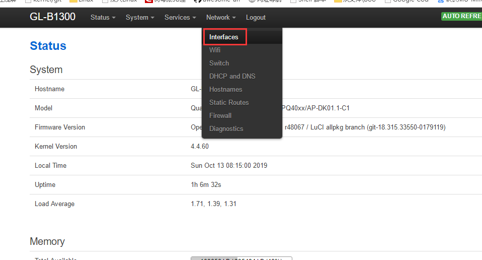

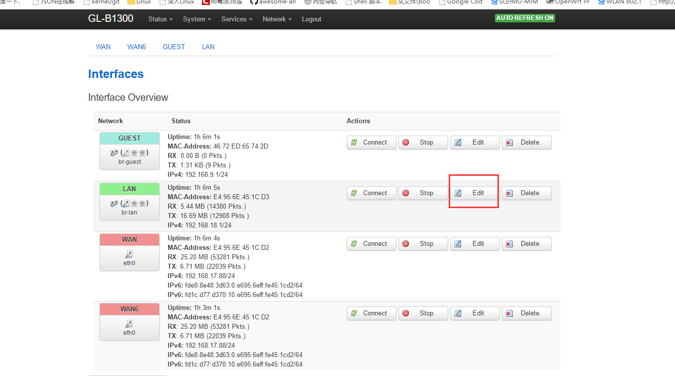

You can also set it through the Luci interface as follows:
Admin Panel -More Settings - LAN IP section

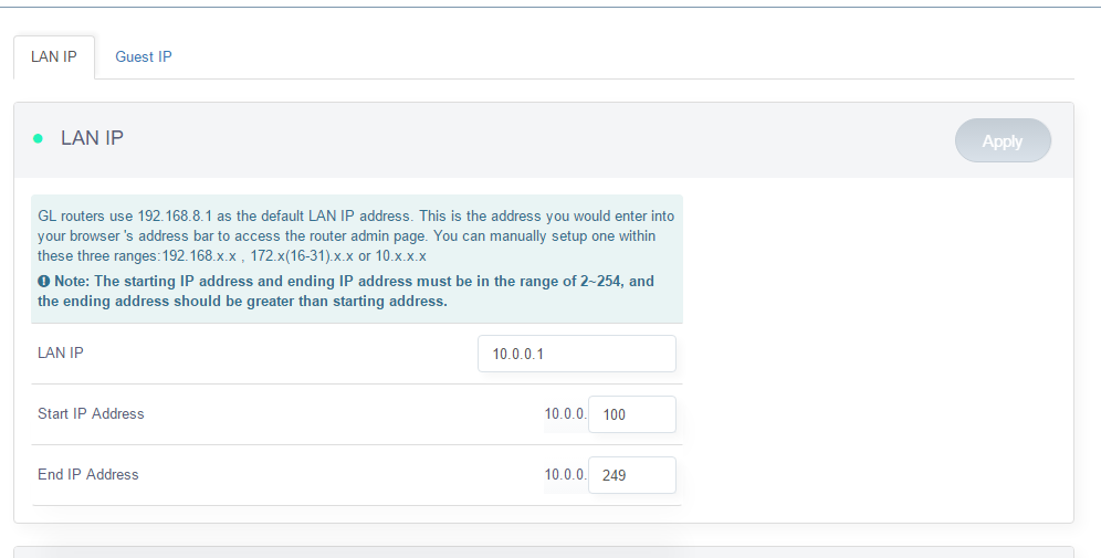

If I change the LAN IP of the Router, say to 10.0.0.138, would that also change the first 3 sections of the Start IP Address & End IP Address to 10.0.0 or would they stay as standard 192.168.1 ??
Would be easy if they change, but if they stay as per original 192.168.1 then I will go into Luci and change as per your advice.
Will be automatically modified to 10.0.0, please see the screenshot below, I am using software version 3.100
Fantastic, thanks for the quick response. Can do that during setup and will save having to go into Luci.
