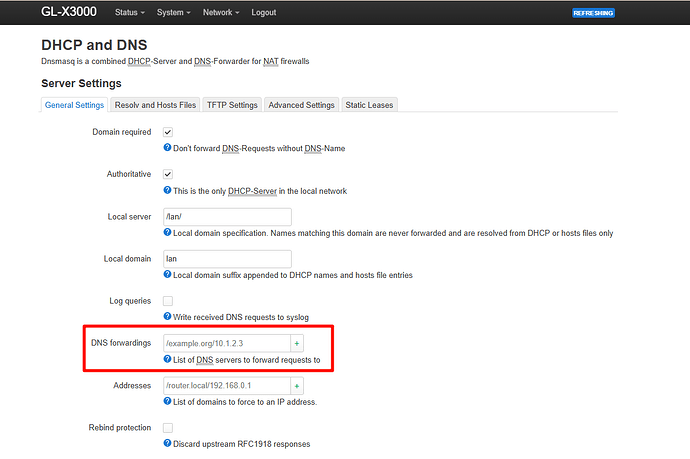

On the flint2, it is easy enough to add to the forwarding list in the LuCi gui. However, the X3000 doesn’t appear to show forwarder configuration in LuCi on 4.7.4. So I will have to do some playing with that to make sure I get the uci commands proper. Any help on this @will.qiu ?
uci add_list dhcp.@dnsmasq[0].server='/myhost.ignorelist.com/8.8.8.8’
uci add_list dhcp.@dnsmasq[0].server='127.0.0.1#5453'

We’ve checked — the X3000 (v4.7.4) firmware still supports DNS forwarding:
Also, your command looks correct, though there’s a small typo — the after 8.8.8.8 should be '.
The order doesn’t matter.

Onward - I have no idea how I overlooked that as it is the same in other routers. All I can say is I must have been staring at it too long lol. I set that and it appropriately routed the request. Without the forward, it resolves the host as 0.0.0.0. Once I enter the forward in there it resolves to the proper ip.
tl/dr - I think this will solve my problem. I simply forwarded the request for myhost.ignorelist.com to 8.8.8.8 for resolution.
