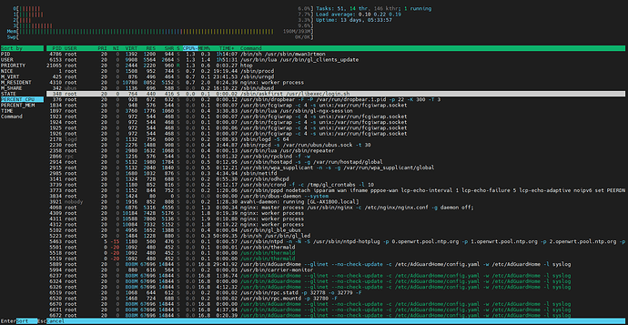

SSH into the router and run:
opkg update && opkg install htop
then run htop and sort by PERCENT_MEM using F6
Something like this will appear:
Now you know what uses RAM.
But 85% for 300 connections is pretty OK, I would say. RAM is for using - unused RAM is useless RAM.

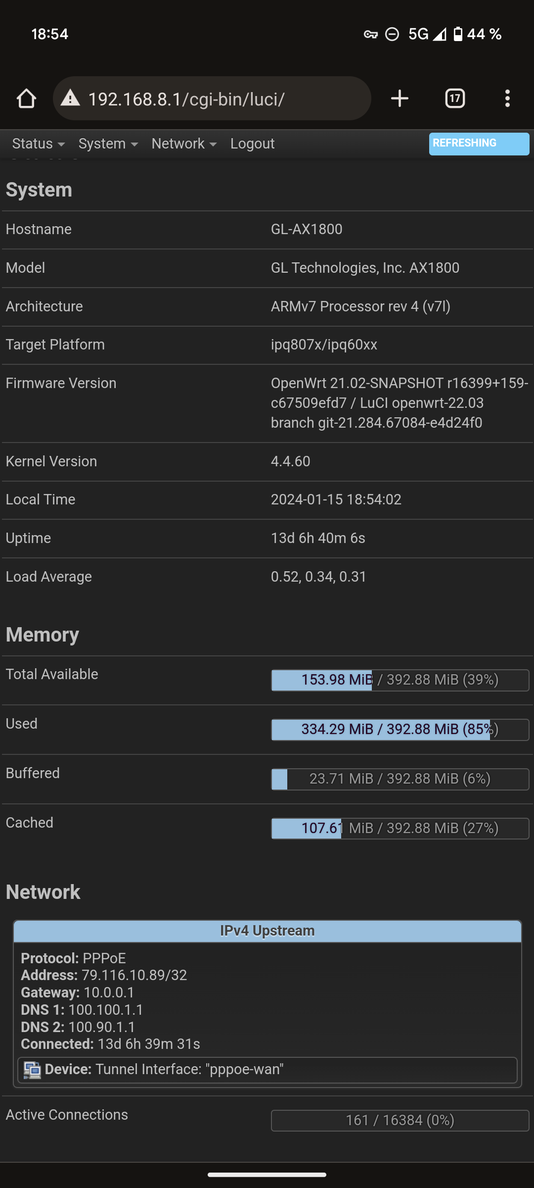

Here they are come pics
I’ve noticed that you have much more memory, 988M and I have 393M. Why?

Because I am using a Flint2 :wink:
