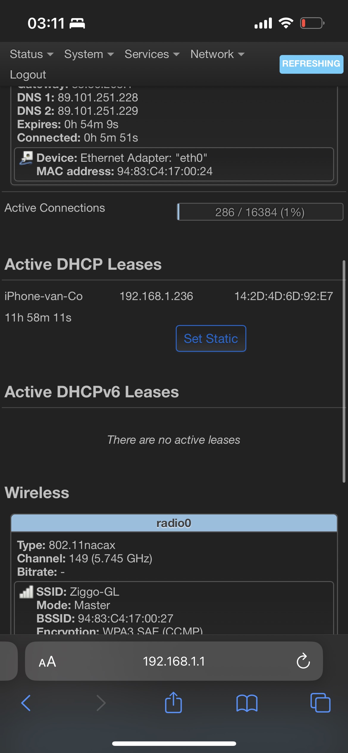

When in the GL router panel, in the clients section, it will show some strange results. IP addresses assigned starting from 192.168.0.1, instead of 192.168.1.1. (See photo’s below).

That’s what I thought too, however all client devices show up in the Flint.
The Deco seems to assign non existing addresses.
