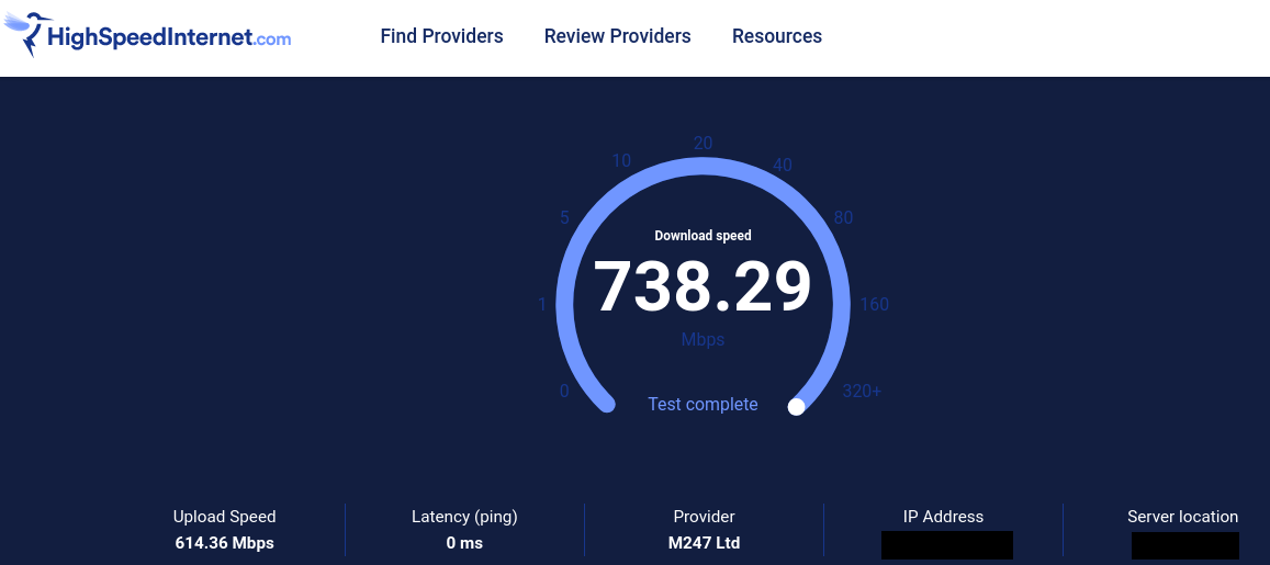

A picture is worth a thousand words some say… Connected to a Wireguard VPN server over a fibre optic line. All I can say is WoW! ProtonVPN is the VPN I’m using.
Wow! So high Wireguard Speed!
Also torrenting on gl-ax1800 thank you

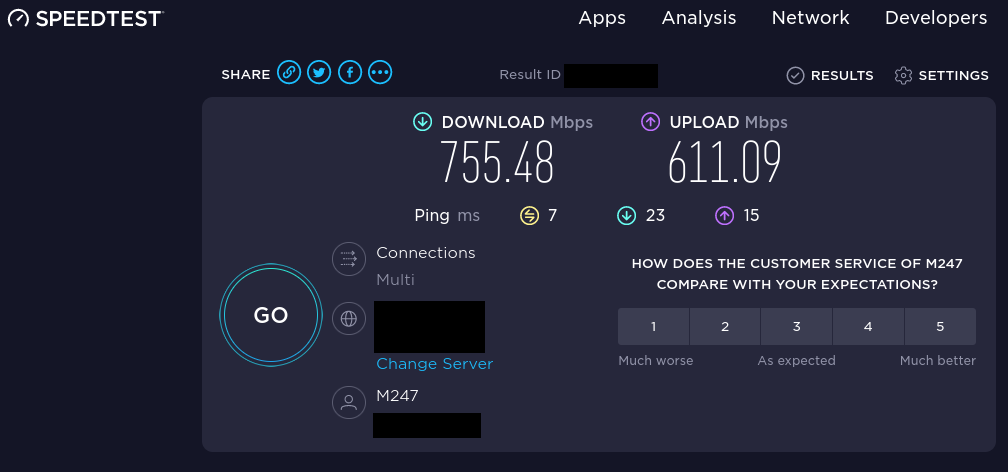

The new WireGuard speeds are indeed very good.
The previous WireGuard speeds should have been significantly higher because the GL-AX1800 webpage has been advertising “VPN encryption speed of up to 667Mbp” with a chart showing 500Mbps for WireGuard. Maybe the ProtonVPN server or something else was limiting the previous results.

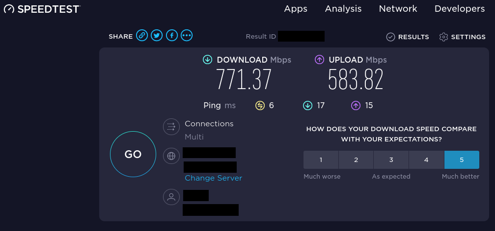

Ok the latest screenshots using the latest firmware release #2.
Mine improved as well especially after I set MTU setting on the Wireguard Client to 1380 instead of the default 1500.
