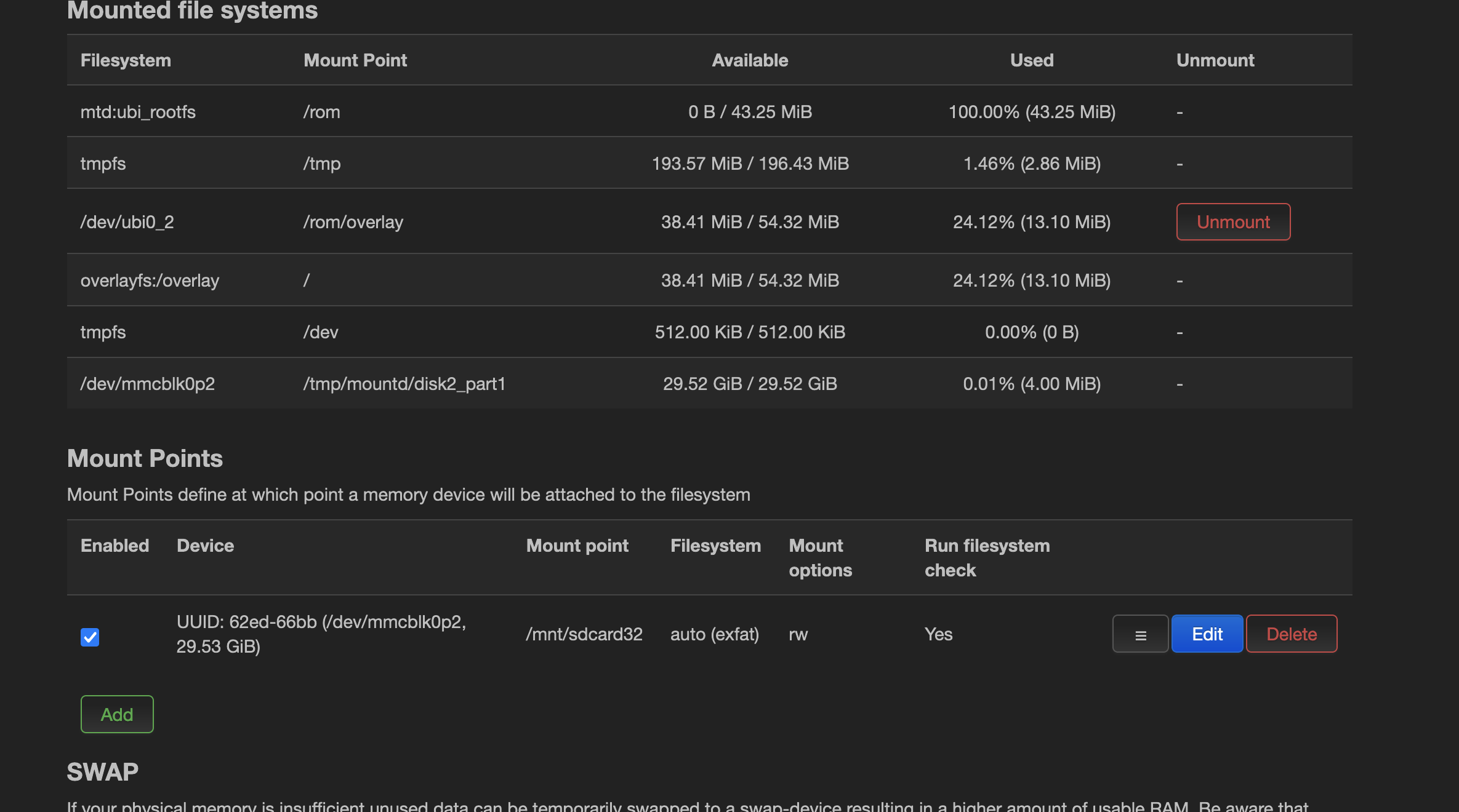

mine doesn’t mount in /mnt/ like any other linux i experienced before …it’s mount in /tmp/mountd/disk2_part1…since it’s default setting i dont to changing it as i still want the stock samba service works …
i only just find out they use block-mount. which is new to me, be honest . i only have some experience using normal mount, changing fstab file before. which is empty now ha ! so it’s very difficult for me. guess i need to keep update my linux skill .
i forget to mention …i did try to use the luci GUI to manually change some mount …but it’s didn’t take effect after reboot …
see when i cat /proc/mounts it’s still on /tmp/mountd/disk2_part1. but when use uci show fstab it’s did have all my manually added config .
my syncthing still can’t write the path …( i did create the .stfolder and .stignore again ) but it’s just disappear itself .ha
