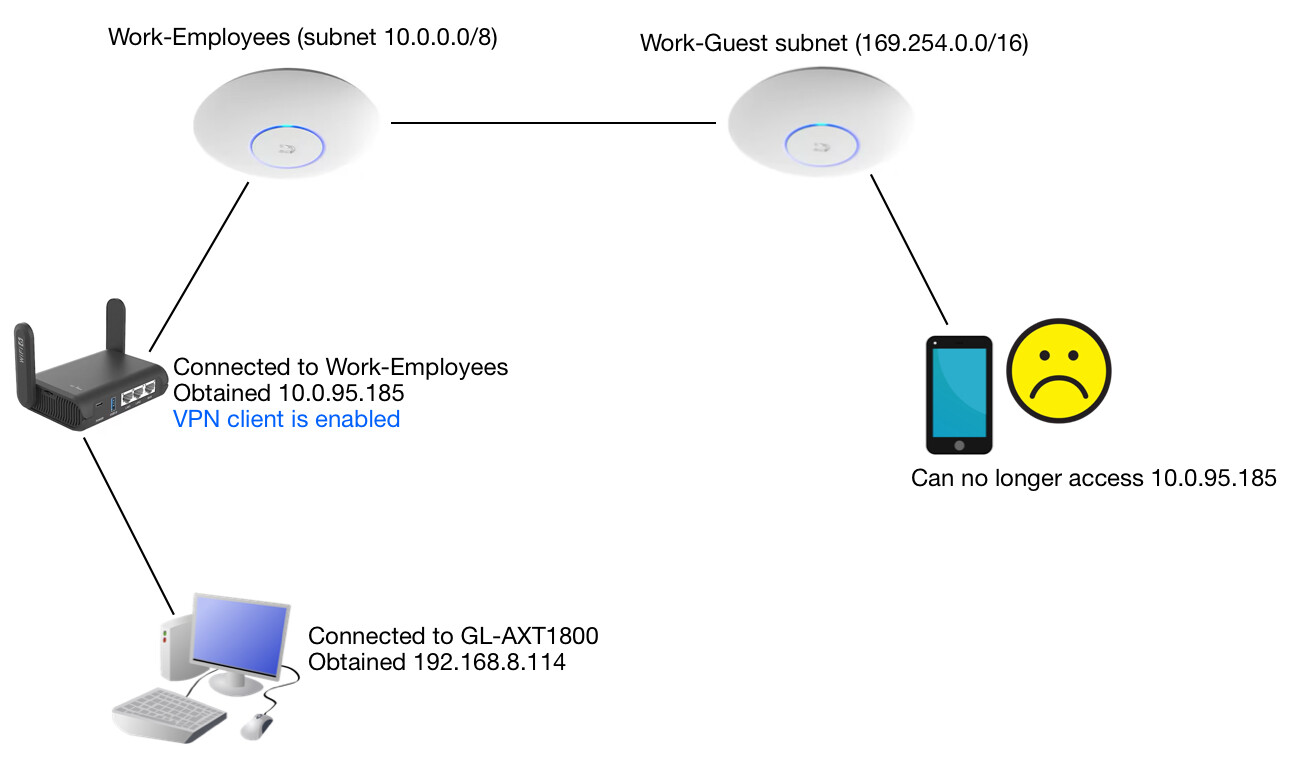

I have a Slate AXT-1800 in repeater mode connected to a network called “Work-Employees.” I enabled the VPN client on the router, and then connected to Surfshark Wireguard config.
I made sure enable “Allow Access WAN” and “Remote Access LAN” on the VPN page. I made sure to port forward and all. I’ve done this many times before. My workplace has 2 networks and subnets that can communicate with each other.
Let’s say “Work-Guest” has the subnet 169.254.0.0/16 and “Work-Employees” has the subnet 10.0.0.0/8. My router was assigned the internal IP 10.0.95.185.
I’m able access to 10.0.95.185 anywhere as long as I’m connected to either “Work-Guest”, “Work-Employees”, or my router itself. However, once I turn on the VPN client on the router, I can access 10.0.95.185 from only “Work-Employees”. I can no longer access 10.0.95.185 from “Work-Guest”.
I reverted to firmware 4.4.6, and this was working properly again. It seems like firmware 4.5.0 broke something. I’m not that techy at setting up routing rules or networking stuff. If anyone could tell me how to allow connections from subnet 169.254.0.0/16, that would be awesome.
I hope this make sense, but I also drew a diagram if helps to understand. Again, this was working before without me needing to touch any advanced stuff.
