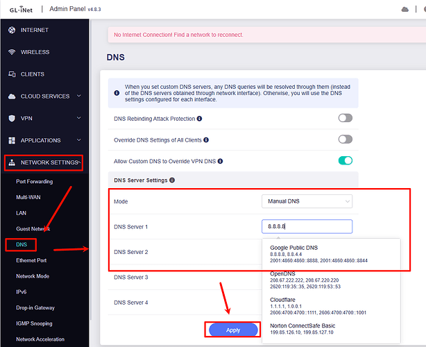

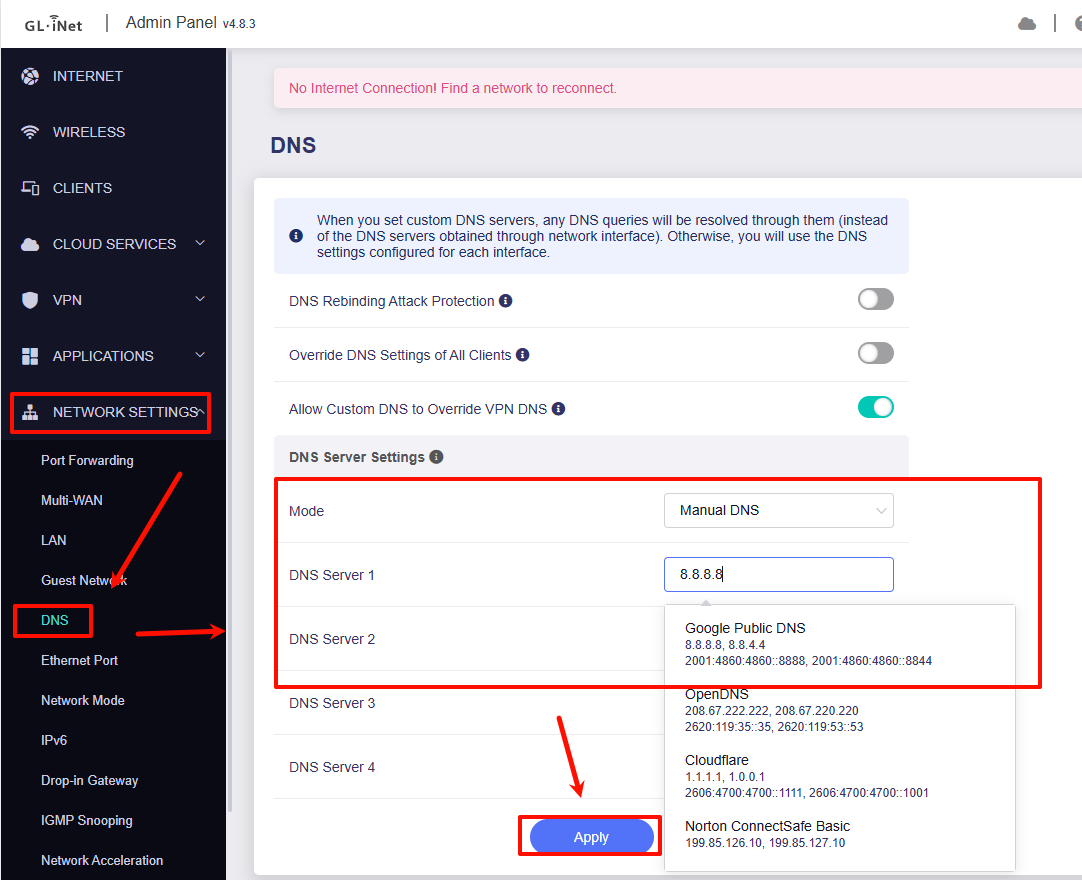

Please follow these checks:
  1. In the Admin Panel under Network > DNS, switch your DNS server to Google DNS or Cloudflare DNS and verify whether the issue persists.
  2. If you are using AdGuard Home or any other DNS-filtering service, verify that the domain is not being filtered or rewritten.
  3. Confirm the domain’s spelling and test its availability from another device or network (e.g., mobile data) to determine whether the issue is local or service-side.

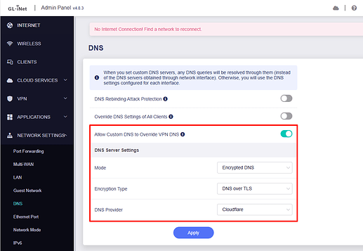

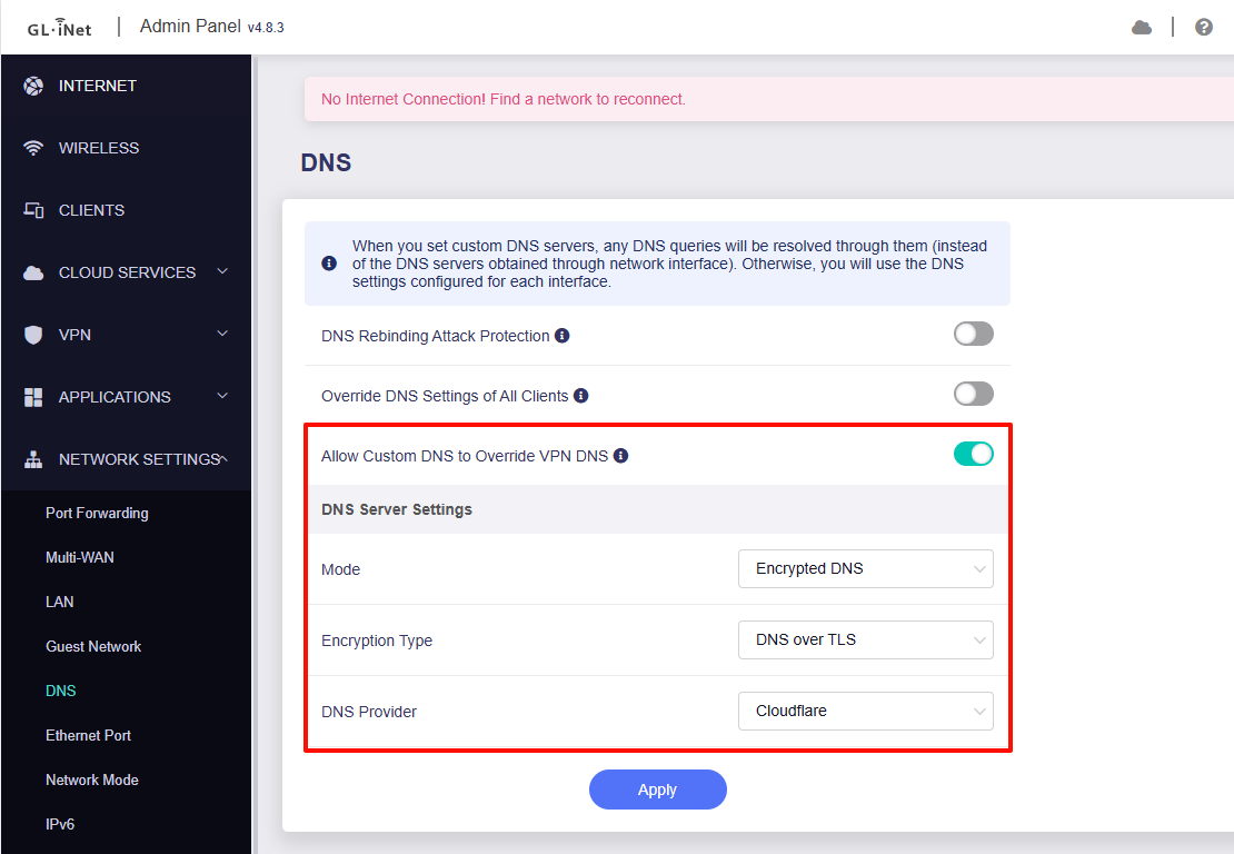

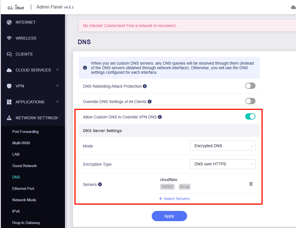

Mullvad VPN redirects unencrypted DNS queries and applies filtering on its own servers.
Please try switching to encrypted DNS.
Note that LAN clients should use the router’s LAN IP address as their DNS server to make this work.
DoT setup:
DoH setup:
