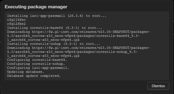

After the new firmware was installed everything became a nightmare. That’s when I started getting these kind of messages whenever I tried to install any package from Github or OpenSource:
”packages for {XXX} found, but incompatible with the architectures configured”
That’s so fucking weird. The aarch64_cortex-a53 package should be able to install, but now every single .ipk file I try to install from any version says it is not compatible with it.
I have been switching from firmware to firmware, testing every single version. Even tried with pure opnwrt, it was so unstable that it made me go back to GL.iNet’s firmware… I have no idea what’s going on but this has me really stressed out. Please help.
Here the version I had installed:
releases/packages-22.03/aarch64_cortex-a53/passwall_luci/luci-app-passwall_26.3.6_all.ipk
