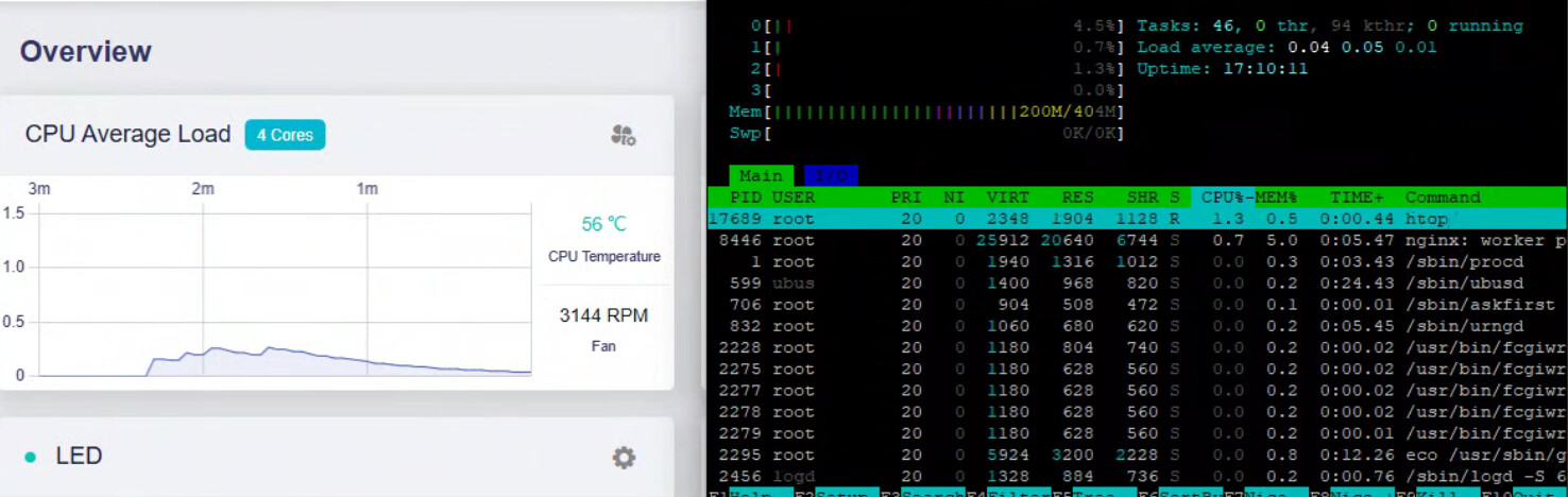

I plan to replace the fan. Although I’ve lowered the set temp to 50C, it concerns me to see / feel the high apparent temps, at 3144 max RPM, during mostly idle loads.
We believe that the operating temperature of the AXT1800 in your environment is not high.
The temperature measured here is the CPU temperature. In most cases, it is normal for the temperature to be below the default setting or the minimum fan start temperature (75°C, 70°C), or to exceed this in high-load or high ambient temperature situations .
Therefore, we do not recommend that you replace it.

It is likely the operating temperature is not too high under nominal factory test conditions. I don't plan on further troubleshooting the default software packages for now as more increased cooling appears to be the easiest fix for instabilities from enabling included software.
Specifically, when enabling AdGuard, the AXT1800 appear to be stuck at some of its hardware limits, with the device stuttering and losing connections. Disabling AdGuard did not stabilize the unit. Fan does not turn on at factory settings. Forcing air into the unit did temporarily stabilize, but factory resets were required to stabilize.

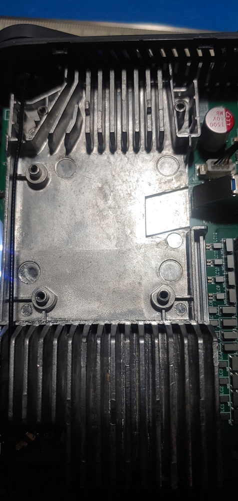

Before seeing the reply, I already disassembled and started summarizing.
I can't tell if 5021-8600 is an old or local PN. Molex Picoblade 51021-0400 appears to be the globally available equivalent wire housing to whatever the fan is using.
3mm wide posts limit about 14.3mm down to about 11.5mm available height
M2x0.4 x 6mm, PWH P0
1.25~1.3mm pitch
Molex Picoblade 51021-0400 housing equivalent, crimps potted with clear material for vibration

AlElec cap:
  • 8mm Dia
  • 12mm H
  • ~19.3mm max under chassis

Bottom chassis:
  • 2x fasteners, M2x0.4 x 6mm, PWH P0
  • 7x latching clips
