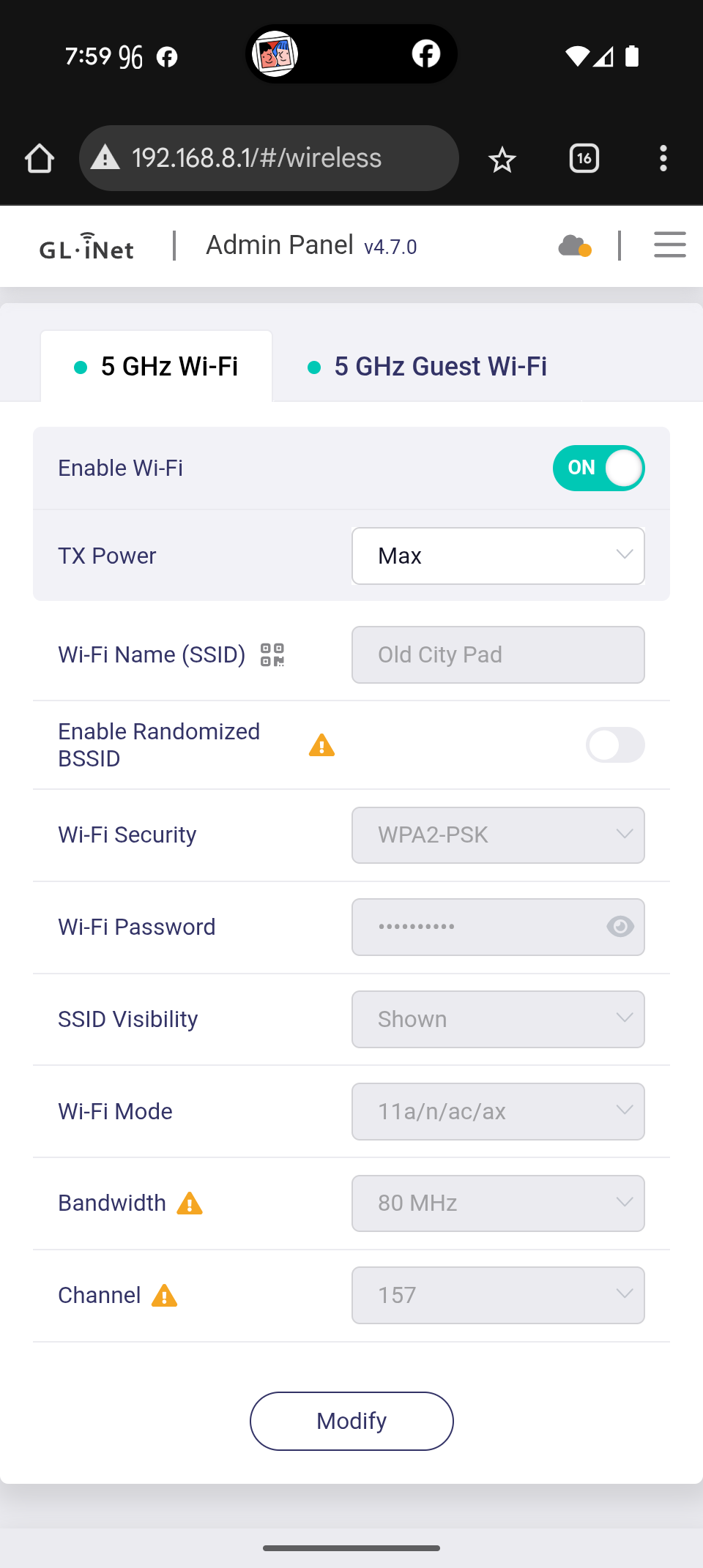

Thank you! I didn't realize that I could downgrade Firmware, which is great. Turns out, I was able to rectify the issue by changing the setting (I think it was "BSSID"?) that blinds the SSID to some devices. I am not on that network now so I can't see the setting in front of me, but that seems to have been the culprit.
Perhaps it was changed to default to "on" in this latest firmware update?
Yes, the Randomized BSSID is on by default.
It may not be caused by the Randomized BSSID, since this does not hide the SSID. The WiFi BSSID will be randomly modified every time the device is started.
We need to check this issue further if you are available to do more test.
I understand that in theory BSSID shouldn't be the issue -- and it may not -- but after my upgrade about 1/2 of my smart devices stopped working on the 5ghz network (no wifi found) but would work on the 2.4ghz network. But when I turned off BSSID everything started working again on the 5ghz network!

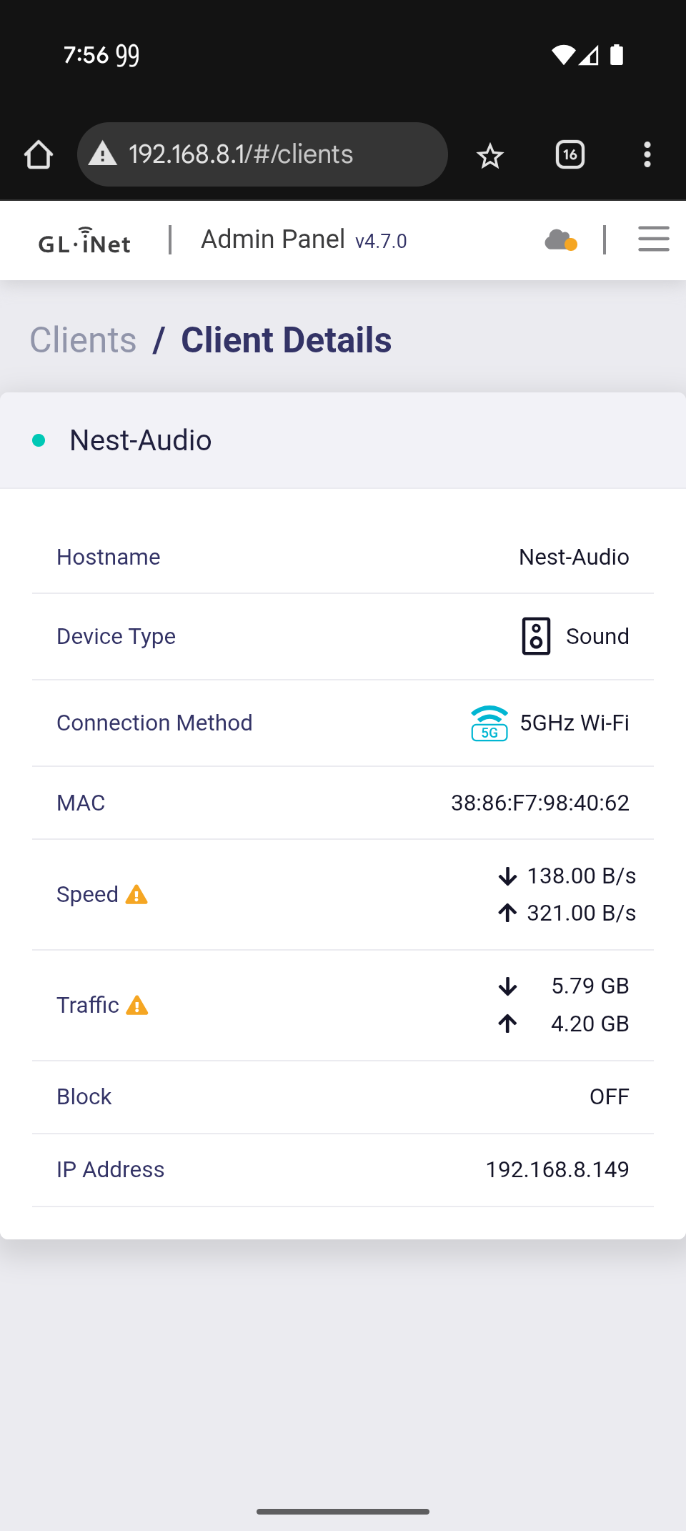

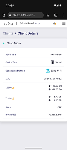

re: 1) The devices do show up in the list, however, when I attempt to modify them (when they're not responding), I get an error message from the app. When they are online, I can modify them just fine. Either way, they are in the list.
re: 2) No. But I'm getting the same message for devices that are "seen" and "not seen": Reply from 192.168.8.207: Destination Host Unreachable.
re: 3) Sometimes, not always. Right now, I have a Google Nest Stereo setup in Google Home, and only one of the speakers is being "seen" by Google Home, even though both speakers are on and responsive. I've rebooted both speakers and the router, but still, only one of the two speakers is being "seen" by Google Home. If I reset the "dead" device and re-set it up, it'll work...temporarily. I have a Google Nest Stereo working in two other locations and they've never disconnected, so this feels very related to this router unfortunately.

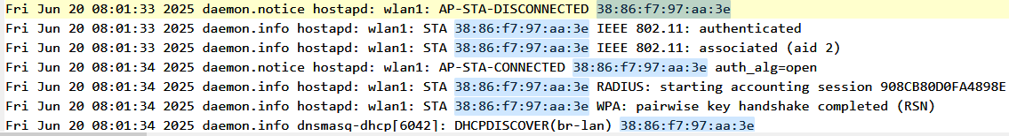

logread.tar (127 KB)
The other screen shots I've uploaded include both Google Nest devices, and you can see the one that's not working/transmitting, while the other one is.

I checked the MAC of the two devices in the attached log and found that the device was disconnected from WiFi, but was connected again. The other one has no exception. I would like to know is this time point which you find that the speaker cannot be searched?
