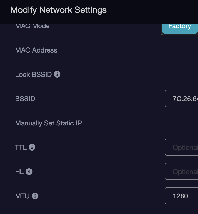

The only other thing I found that I thought maybe useful to try out was setting the MTU on the WISP Repeater to 1280 to match the tailscale limit[1]. Unfortunately this didn't seem to have any effect.
