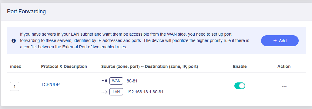

GL-B3000 (Marble) Web-UI Port Forwarding - no port range possible
I can add port forwarding entries below Network>Firewall with a single port.
Unfortunately it is impossible to add a port-range like 20-21 in web-ui as suggested in the manual Port Forwarding - GL.iNet Router Docs 4
The manual is related to firmware version 4.6 - but for GL-B3000 no newer stable version than 4.5 is available.
Is there an solution without usage of the beta 4.8 version?
Please try manually upgrade the v4.7.2 beta firmware, this version supported the range for port forwarding, like this
https://dl.gl-inet.com/router/b3000/beta
After upgrade to Version v4.7.2 beta the range for port forwarding works!
