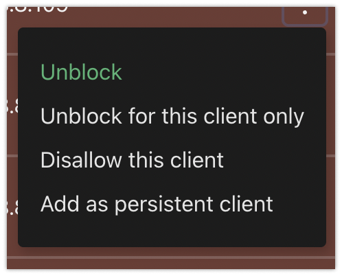

after pressing save button or anything GL-BE3600 goes into 7-10min reboot
even is click block unblock domain and etc
basically even small changes triggering long ass reboot :wink:

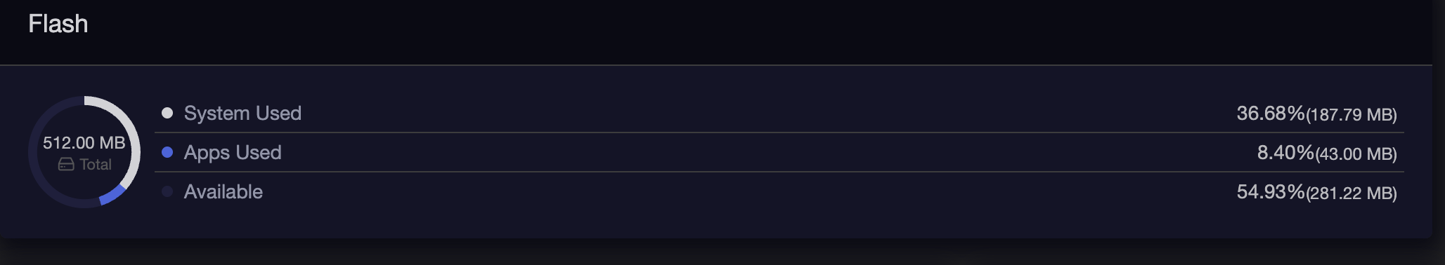

My GL-BE3600 shows 512mb of RAM for some reason

Imho I don't think Beryl 7 will work nice with Adguardhome even with a single list.
The issue is that the wifi drivers take so much memory that by default without adguardhome it is already 70%.
I find 70% risky for other list based programs/plugins.
