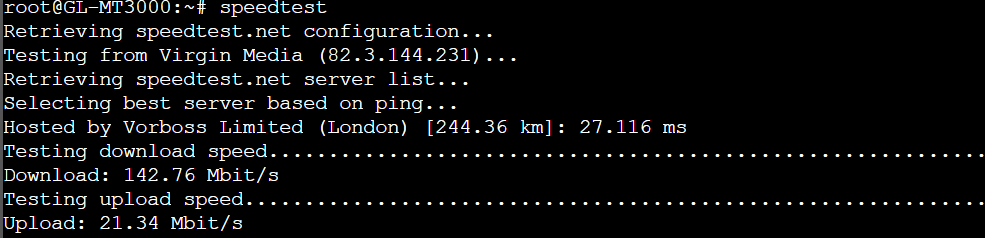

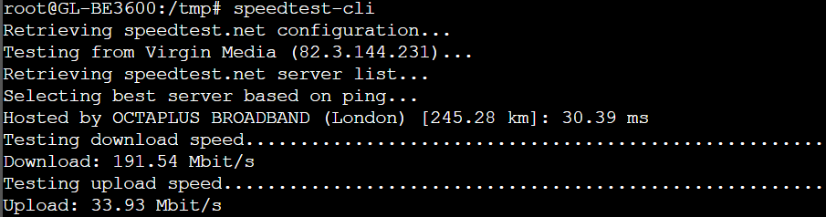

I've set the Beryl up in the same room now.
The strange thing is, now they both seem to be hitting speeds of around 350Mbps each.
It's really odd though because when I had the Beryl setup here last time, it was consistently hitting around 400-500.
I'll leave them both setup so you can take a look at least. Perhaps your engineers will spot something.
The speed on the Slate isn't bad by any means btw, it's just that when I was testing it previously, the Beryl seemed faster every time. It's just typical that now I set it up for you they seem to be hitting the same speeds!
Yep, the Internet speeds of Slate7 and Beryl AX now seem to be very close, and Slate7 is slightly faster than Beryl AX.
