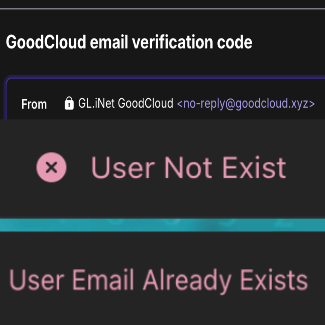

Not as strange as BugyClouds forgetting—again—that I already signed up...
Now I’m locked out and can’t even reset my password.

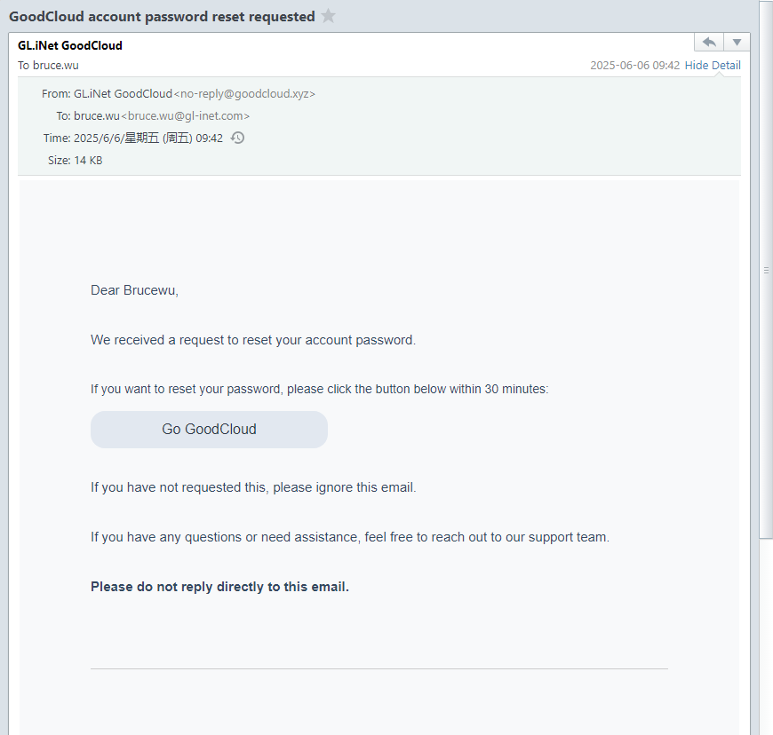

I assume you need to reset your GoodCloud password, the reset email is received, click Go GoodCloud, please enter the new password directly and submit it.
Please make sure that the email/account you entered is correct.

May I know is the initial letter of your account capitalized?
There seems to be an issue, already asked R&D to check.
Please try to reset the password by filling the email address in all lowercase, and it is supposed to receive the email of reset the password.

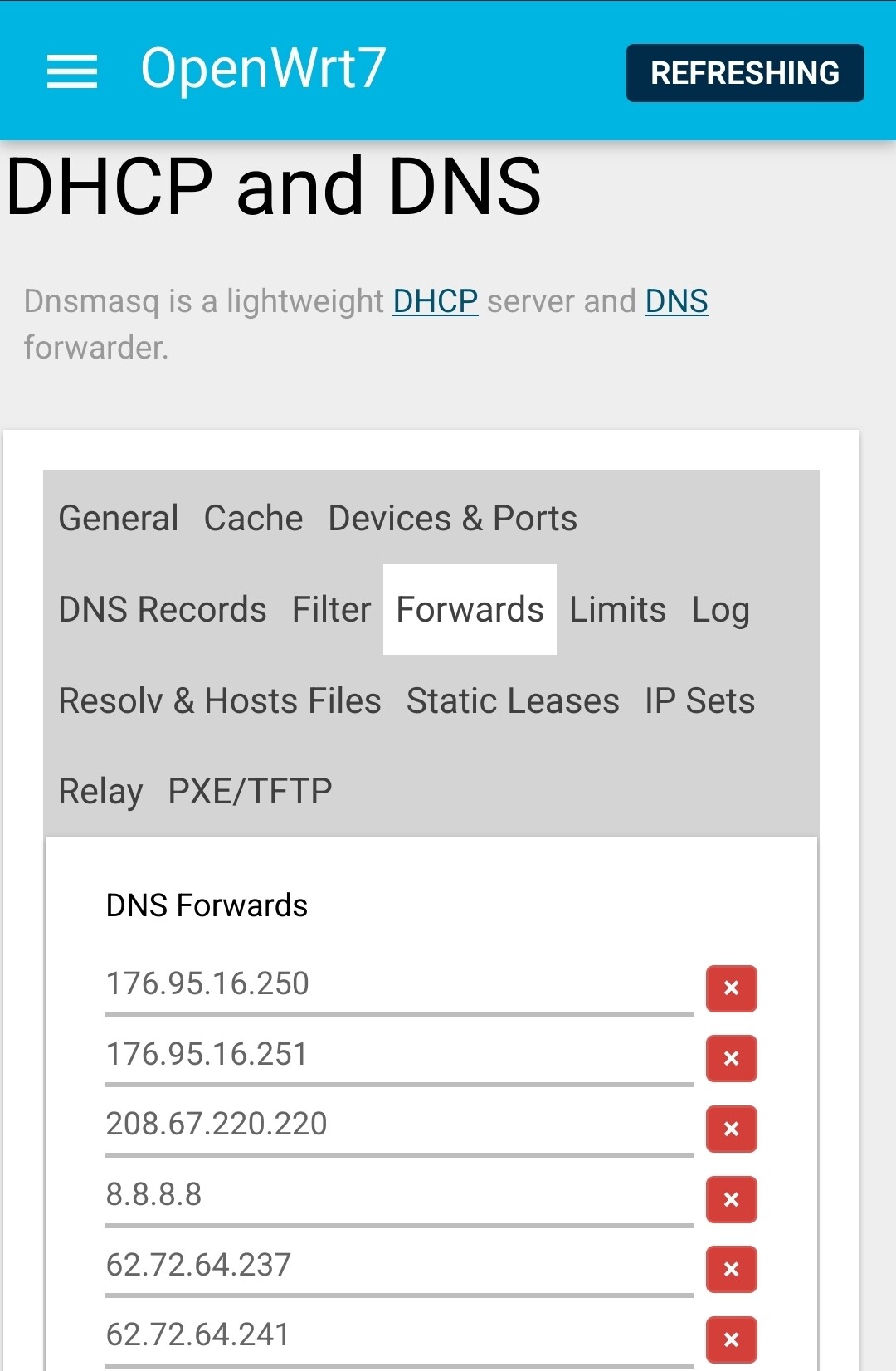

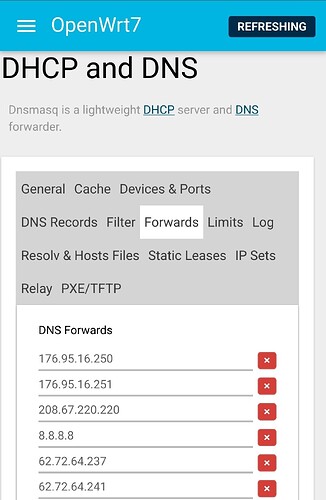

You may add DNS forwards under DHCP & DNS in the Networking tab on your Slate7.
