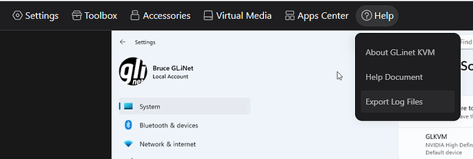

Could you please export the device log to us next time when this issue happen?
If I do not know when the disconnection happened does that matter as far as the disconnection is concerned? I haven’t used the exit node since posting this and the KVM has not dropped connection in that time either. I could enable the node again and see if it drops today but will the log show the disconnect? also how do I export the log? is it in the interface that I access in the webportal?
Yes you can export the log here.
